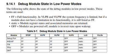

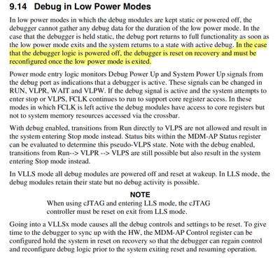

About low power mode debug, you can refer to the section "9.14 Debug in Low Power Modes" and section "9.14.1 Debug Module State in Low Power Modes" of the K64 Reference manual.
From the above content, it can be seen that normal debugging under VLPS/VLLSx is not possible.
However, you can mantain the debugger on so when the device will wake up you can resume the code analysis, please refer to Attaching to a Running Target with Segger J-Link, GDB and Eclipse | MCU on Eclipse.

Thank you for the reply. I "Accepted the Solution" but a note I wrote didn't make the trip. Sorry if this is a duplicate: Section 9 and other docs all discussed JTAG, not SWD. Switched the debug connection to SWD and no resets and the debugger resumes operation when the controller switches out of LLS.
