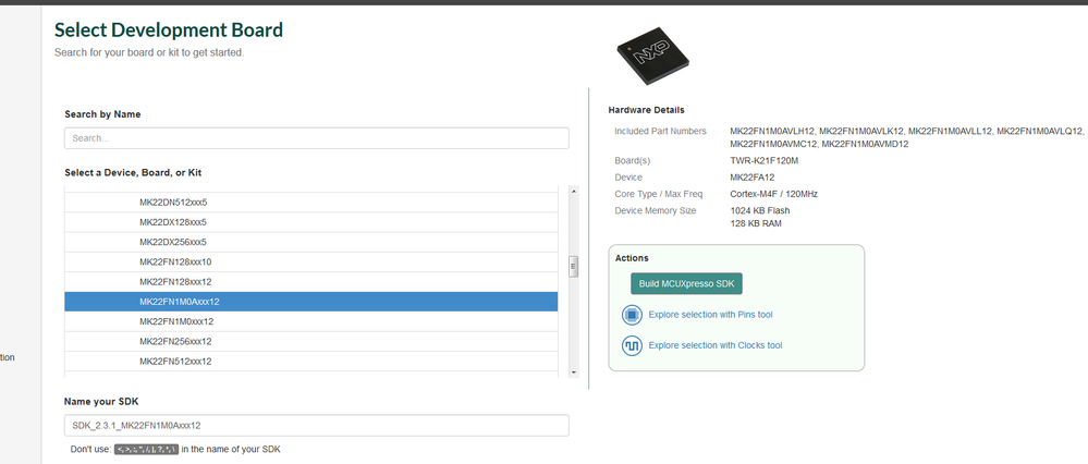

kerryzhou
Hi mylim,
    What's the code you are using now?
   Do you mean you use the FRDM-K22 sample code?
   If yes, you are wrong, your chip MK22FN1M0VLH12 can't use the FRDM-K22 sample code, you need to refer to the TWR-K21F120M code, you can download the SDK from this link:
Welcome | MCUXpresso SDK Builder
Choose the processor as MK22FN1M0VLH12 , generate the code and download it:
Please note, after you download the code, you also need to change the according chip device file to the K22, please check this folder:
SDK_2.3.1_MK22FN1M0Axxx12\devices\MK22FA12
You can try it on your side.
