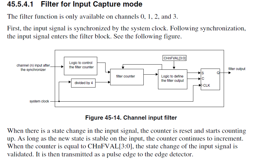

Hi, Eric,
You connect the external capture signal to FTM_CHx pin(just FTM_CH0/CH1/CH2/CH3 pins have digital function), in order to debounce the input signal, fortunately, the FTM input pin has digital filter function, I think you can use the digital function of the FTM input pin to debounce the noise signal.
This is the section of the digital input pin in RM of K66.
You just need to write the FTMx_FILTER register to set up the width of noise, it is okay.
As Mark and you said that the GPIO pin has the digital filter function.
Hope it can help you
XiangJun Rong

ericoneill
Hi Xiangjun,
Unfortunately, the hardware I'm working with doesn't have any FTM channels 0, 1, 2, or 3 brought out. This seems like a good solution though, so I'll see if I can get access to one of these channels in the next board revision.
