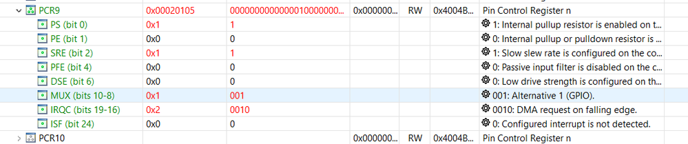

Check that DMA triggering is enable in PORTC_PCR9 - that is, set bit 0x200.

Sorry I don't understand your point. PORTC_PCR9 is setup so:
It seems OK.
Thank you very much for helping. I appreciate.
6,051 Views
mjbcswitzerland
Specialist V
The DMA edge is set OK. PE is a bit confusing for me since it doesn't use easily understandable defines and I mis-read the setting.
