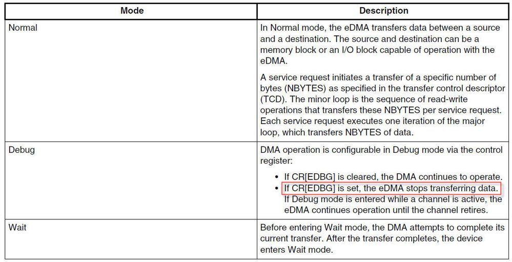

I've review your SR question. Could you tell me what's the configuration of the CR[EDBG] bit?
Since the DMA operation is configurable in debug mode via the bit.

I have set the DMA_CR.EDBG bit to 1.

Regarding the CR[EDBG], you could that the eDMA will stops transferring data if CR[EDBG] is set.
So I think it may be the reason of your project didn't work properly.
