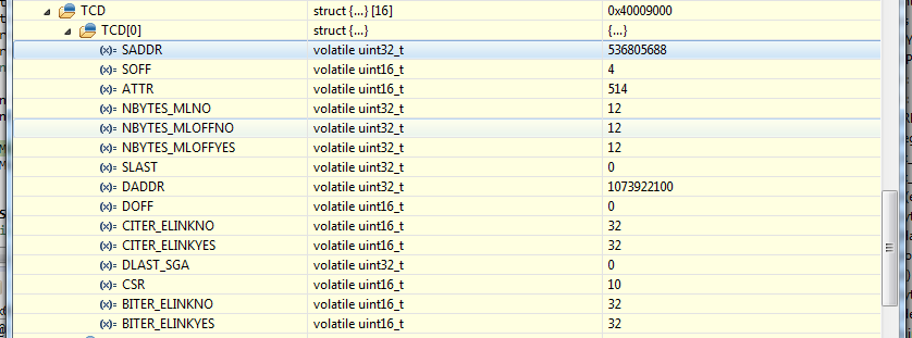

Could you provide the eDMA Channel 0 TCD configuration value (registers value) for DSPI0 TX?
From your code, I find the DSPI0 related pins setting  and DSPI0 setting correctly.
I want to make sure the GPIO trigger eDMA will transfer the correct value to SPI0_PUSHR register for SPI0 transmit.
Thank you.

Hi please found the TCD0
And again, if your expert team can build a true code example that compile to prove me it is working, it will be nice.

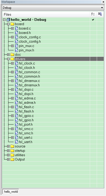

Please check my test code attached, which is based on [hello_world] demo located at:
\SDK_2.2_FRDM-K64F\boards\frdmk64f\demo_apps\hello_world
For I test on the FRDM-K64F board, the SW2 pin is using PTC6 pin as EDMA trigger source.
Customer can refer to use PTDx pin as EDMA trigger source.
The test result is below:
Software structure:
Wish it helps.

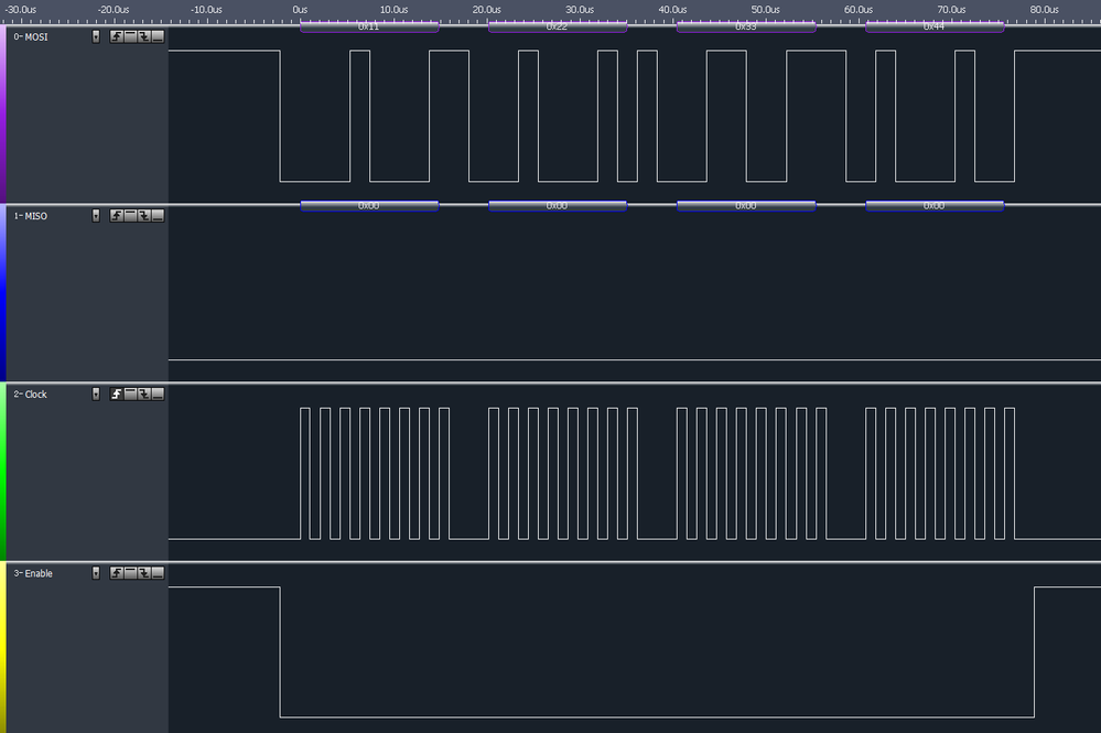

I have a complete solution for this in the uTasker project, which allows port triggering to write/read SPI sequences without any interrupt overhead. Below are some details and I have attached  binary that you can load to a FRDM-K64F to check the behavior.

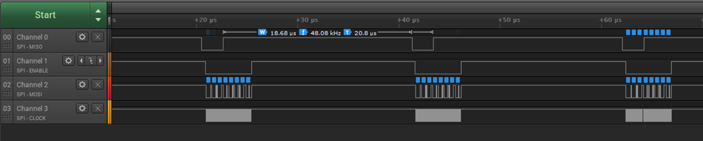

1. If you load the binary to the board you will find a 48kHz PWM output on pin J2-4 (PTC4). By connecting this to J2-20 (PTE-24) it will be used as the port edge DMA trigger (or else you can apply faster clocks to the pin too if you prefer).
SPI0 is used (this has a 4 deep FIFO on Tx and Rx - SPI1 and SPI2 have only 1 deep FIFOs but this is in fact not relevant since the DMA operation is the same for all). This means that SPI0_CS0 can be measured on J2-6 (PTD0), SPI0_SCLK on J2-12 (PTD1), SPI0_SOUT on J2-8 (PTD2). By connecting J2-8 to J2-10 the output can be looped back to the input.
This is what the signals look like (SPI sends 0x01, 0x02, 0x03, etc.)
As seen, the SPI sequence is started by the falling edge of the input.
The received data is stored to a buffer which can be of any size. There is an interrupt when it is half full and when it is completely full and this can be used to retrieve the data from this half while the next is still filling (ping-pong buffer). It is in fact optional since it is also possible to use no interrupts and still successfully receive the data.

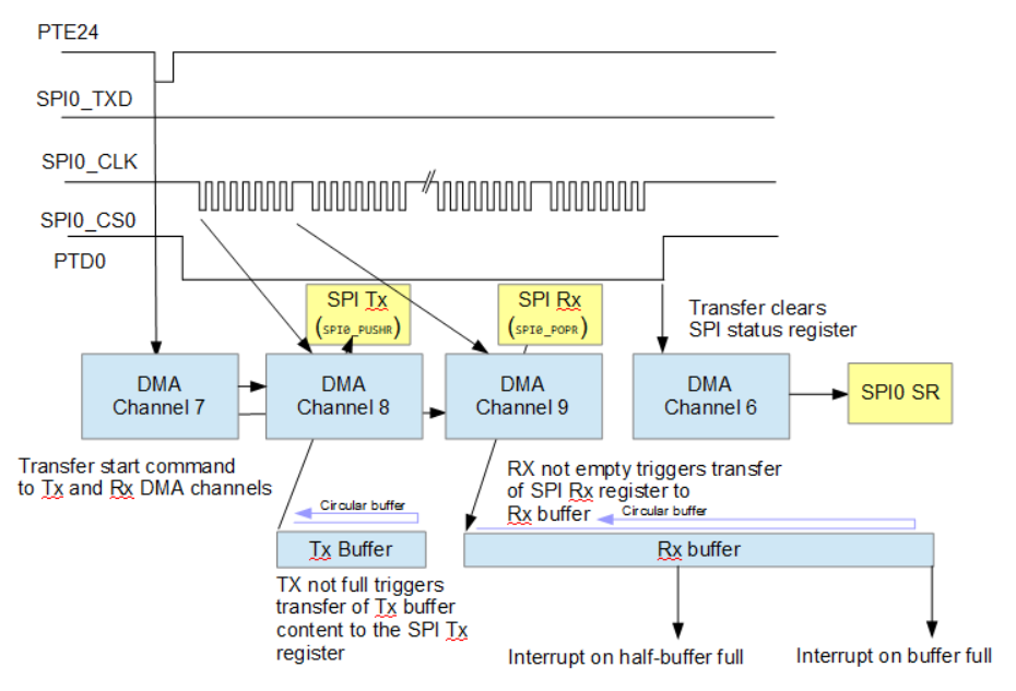

3. This diagram shows how 4 DMA channels are required, whereby there is a slight complication since it is also necessary to clear the SPI status register flags after each transfer so that it can continue (otherwise only 3 would have been necessary)
Conclusion:
- Is is very simple to achieve extremely efficient SPI operation of this type, allowing very high speed sampling rates without CPU intervention. By setting a large Rx buffer the CPU can read and process the data at leisure without risk of overruns.
Final notes: the attached binary also has USB-CDC on the USB and a TCP/IP stack operation on the Ethernet (IP 192.168.0.5) to show that the high speed SPI sampling doesn't interfere with the other operations.
