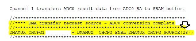

Hello Every one.
I am using the DMA to get the ADCs result to a buffer as stated in AN4590 application note.
In the note during DMAMUX channel request source selection I am confused how the source number is given. like for ADC0 they have given 0X28 and for other channel its 0X36. My question is where does these 0x28 and 0x36 comes from and in which section of configuration manual r they stated? i have seen ADC and DMA and DMAMUX chapters but I couldnt find that.
here are the lines from AN4590
Abdullah

See the "Chip Configuration" section chapter of the user's manual. Then the "DMA request multiplexer configuration" in it.
This gives a list of the DMA request sources for MUX 0 (and MUX 1 for bigger chips).
eg.
UART0 Rx is 2
UART0 Tx is 3
UART1 Rx is 4
UART1 Tx is 5
ADC0 is 40 (0x28)
Double-check this because it looks wrong: ADC1 is 0x29, ADC2 is 0x2a (on MUX 1 only) and ADC3 is 0x2b (on MUX 1 only).
