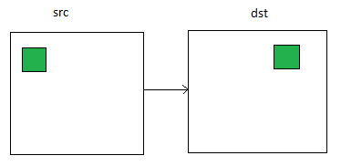

I have a question regarding Memory To Memory transfer on K70 of a block of memory from source to destination using different offsets after each line has been processed (minor loop) (Figure 1). What is the most effective solution for this?
                                             Figure 1
The only method that seemed applicable from documentation is to use DMA_TCDn_NBYTES_MLOFFYES (Minor Loop and Offset Enabled), and apply MLOFF (Bits 10-29) to BOTH source (SADDR) and destination (DADDR) - But i'm interested in using different offsets. (I haven't been able to find any usage exampels on this scenario).
How does DMA_TCDn_DOFF / DMA_TCDn_SOFF relate to MLOFF in this case? Will using DOFF and SOFF in combination with DMA_TCDn_NBYTES_MLOFFNO (Minor loop enabled and offset disabled) give us the same as using DMA_TCDn_NBYTES_MLOFFYES which has a built in offset?

Thank you so much for your reply. I don't think i can use one single minor loop and thereby transfer all the data continuously. My destination is a framebuffer for the LCD controller, and i'm moving small graphical elements of a constructed view in memory to that framebuffer. The only way the DMA_TCDn_NBYTES_MLOFFNO works is if i'm transfering graphical elements that take up the entire display.
This is why i have to be able to transfer a small block of memory, that is not continuous, to the framebuffer. Figure 1 was meant to depitct graphical elements, this might not have been made completely clear by me (sorry).
Does that make sense? Look forward to your thoughts on this.

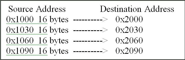

If the source address and destination address with same offset, such as below picture shows:
You can use one major loop with 4 minor loop, each minor loop transfer 16bytes data and need to set DMA_TCD_NBYTES_MLOFFYES [SMLOE] & [DMLOE] bits and set DMA_TCD_NBYTES_MLOFFYES [MLOFF] value to 0x30 (it also need to set DMA_CR[EMLM] bit to Enable Minor Loop Mapping).

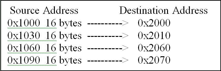

If the source address and destination address without same offset (as below picture shows), customer need to use 4 major loop and use channel link way to do data transfer.

mkjeldsen
Hi Hui,
Thanks for a great reply! Your method #2 looks exactly like what i'm looking for: Source and destination with different offsets.
I suppose for X number of transfers (= X major loops), we would have to set up some kind of dynamical TCD configuration for each channel. And we would then simply use 1 major loop without minor loops? Would specifying a pool of Y channels to use for linking be a decent method? Is there a certain number of channels for linking you would suggest for an approach in which the number of major loops (lines) might vary from a small number and up to the height of the display?
