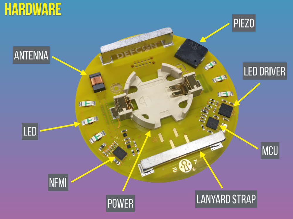

The badge has these two NXP devices:
  • KL27  - MKL27Z64VDA4 - 48Mhz ARM Cortex M0+ microcontroller w/ 64KB flash (Datasheet and Reference Manual)
  • NXH2261UK- Near Field Magnetic Induction (NFMI) chip for the wireless communication. Has a range on the badge of about 6 inches (15cm), but the technology can work a bit further. It's often found in high end headphones because BLE waves are disrupted by your head but these waves aren't. Also less power consumption.

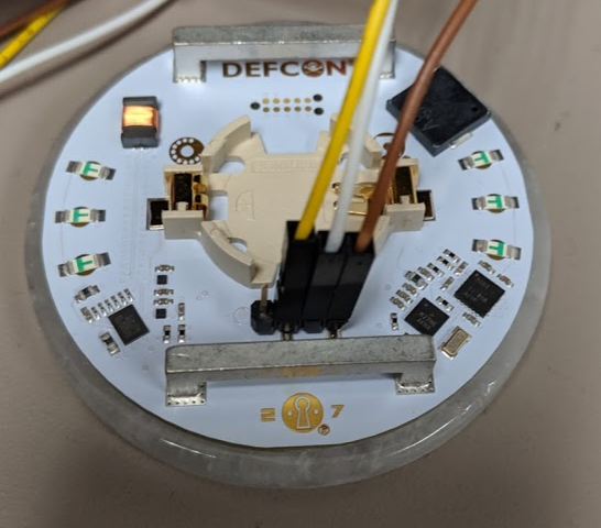

1) Plug the 3.3V or 1.8V USB converter dongle into your computer and it should enumerate as a COM port.
2) Connect the GND line on the dongle to GND on the header
3) Connect the TX pin on the dongle to the RX pin on the header
4) Connect the RX pin on the dongle to the TX pin on the header (it is not RX to RX, I spent 2 whole days tearing my hair out over that during my robotics project in college)
5) DO NOT CONNECT THE POWER PIN
5) Should look like the following when finished

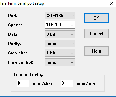

6) In your serial terminal program, connect to the COM port your dongle enumerated as
7) Find the serial port settings menu (in TeraTerm it's in Setup->Serial Port from the menu bar) , and set the baud rate to 115200. The other settings should not need to be changed (8 data bits, no parity, 1 stop bit).
8) In the terminal, press enter. You should get a > prompt

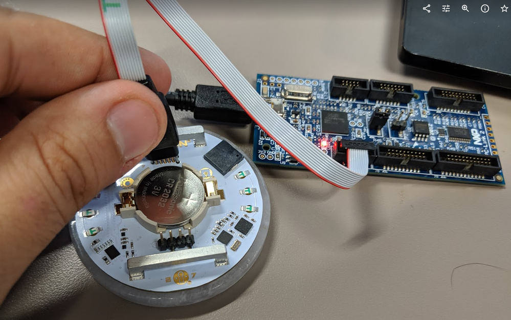

The DEFCON badge has the footprint for a Tag Connect TC2050-IDC-NL-050-ALL. Because this cable is meant for manufacture programming and not day-to-day debugging, if you plan on stepping through code, you'll also want to pop off the the quartz front and get some retainer clips to keep the programmer connected to the board.
If you just simply want to reprogram the board, you can just snip off the 3 long guide clips, and press the cable against the PCB while holding your hand steady for the ~5 seconds it takes to flash it each time.

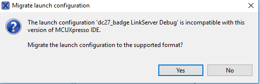

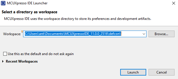

Getting Started with MCUXpresso IDE:
     1) Open up MCUXpresso IDE. When it asks for a workspace directory to use, select (or make) a new empty directory that is in a different location than where you          downloaded the firmware source.

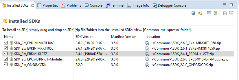

2) Drag and drop the SDK .zip file from your file system into the MCUXpresso IDE "Installed SDKs" window. This is how the compiler learns about the KL27 device and the flash algorithms.
3) Drag and drop the badge firmware folder from a file explorer window into the MCUXpresso IDE "Project Explorer" window

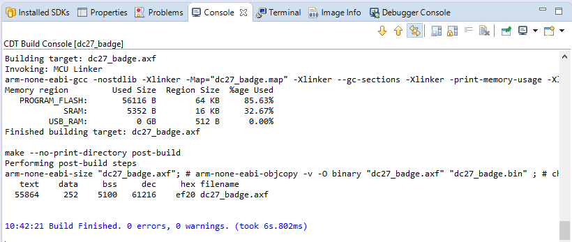

4) In the Quickstart panel hit Build
5) In the Console tab, you should see the message that it compiled successfully

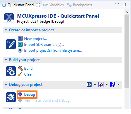

7) In the Quickstart panel hit Debug.  If you're not using a LPC Link2 for programming, you'll need to hold Shift when clicking this the first time so it'll rescan for your debugger.  If using the latest MCUXpresso IDE, you'll see a dialog box that the launch configuration needs to be updated. Click on "Yes".
7) A dialog box will come up confirming your debug probe.
8) Connect the programming cable to the board and press to make a good connection. Make sure the alignment pins match up with the alignment holes on the PCB, and that pin 1 (the red stripe) matches the photo below. You may hear the badge beep, as it's being reset.
9) Then hit OK in the dialog box to start programming. Make sure to keep the probe held there until the programming is finished - about 5 seconds.
10) You should see it program successfully and hear the board beep as it reboots.

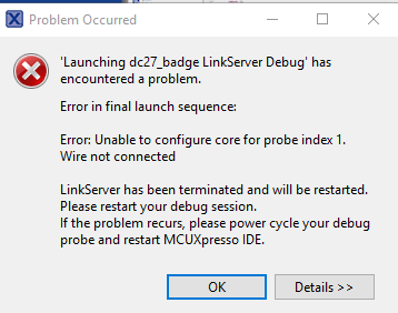

If you're not using a LPC Link2, hold down the Shift key when you hit the Debug button, and it'll re-search for new probes. Also make sure your debug settings and probe is using SWD mode and not JTAG mode.
If you have the programming cable not lined up with the pads, you'll see this error. Re-align your probe and try again. Also you must have power from the battery as the MCU needs to be turned on while programming.

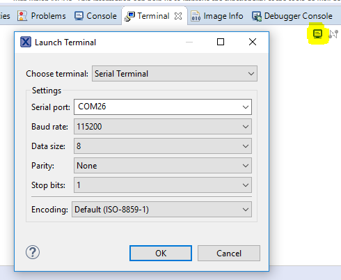

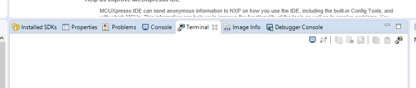

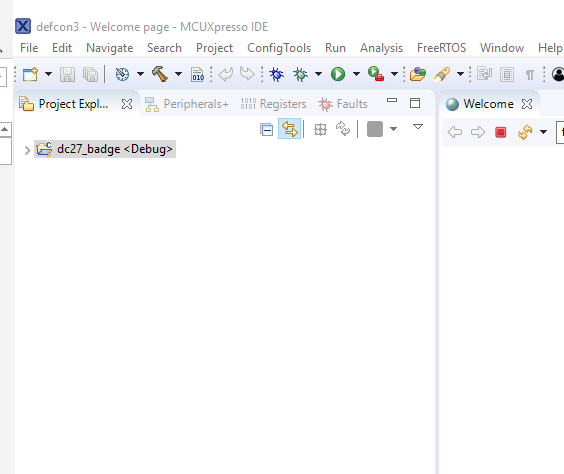

MCUXpresso IDE 11 includes a serial terminal function now, so you dont even need to download PuTTY or Teraterm :smileyhappy:
In the default layout its grouped with the Installed SDKs, Console, etc:
Click on the terminal icon (highlighted yellow below) then select Serial Terminal:
et voila!
