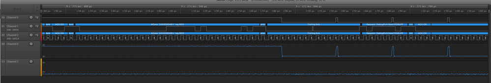

I designed a custom K24 board which is fairly simple:
- J-Link Segger header
- All pins broken out
- Power routed
- Decoupling caps
- Optional pullups for reset and SWD data, optional pulldown for SWD clock
https://oshpark.com/shared_projects/IVFTmKsz
Using 200 Khz SWD speed, have EZP_CS_b pulled high. Tried at 1.8 and 3.3v both.
I have populated:
SWD data pullup: 4k7
Reset pullup:4k7
Clock pulldown: 4k7
Clock capacitor to gnd: 560pf
In the middle of the launch process, it fails back to a reset loop.
Channel 0: Reset
Channel 1: Data
Channel 2: Clock

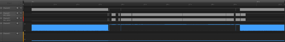

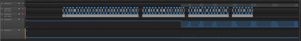

Full view:
Zoomed in on where it starts the reset loop again:

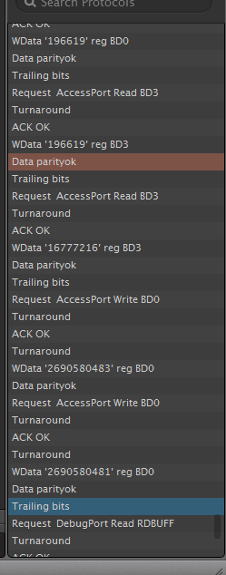

The 'Trailing bits' section is where the reset loop starts:
Zoomed out a bit around the area where the reset loop starts:
I assembled a second board which exhibited the same failure. What is going wrong?

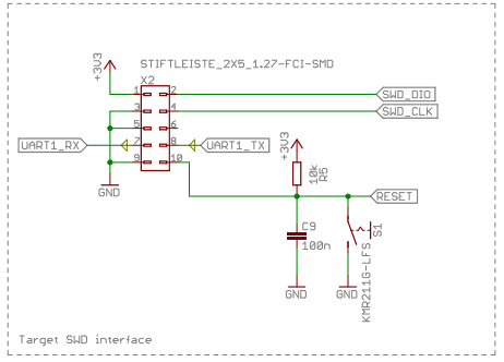

Hi Jacob,
I notice that your SWD target inferface speed is rather low (not sure how much it matters), but I'm using 1000 kHz (you have 200 kHz). I have pasted an example session on my side (FRDM-K64F).
The other thing which might be relevant:
>>>Target voltage: 1.77 V
Is it really that low?
I have used the circuit/wiring as on the FRDM boards with my design with no problems so far:
- 100n C on Reset to GND
- 10k pullup on Reset to VCC
- SWD CLK and DIO directly to the MCU pins (no pullups and no caps)
Erich
