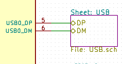

2. My USB pins are connected to the K22 as shown below. Is there any setup I need to do for my microcontroller to make use of that USB port for bootloading? Do I need a processor expert component to make use of this USB (such as USB-HID)?

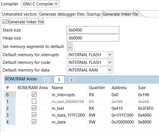

3. I'm not sure as to why I am getting these errors when I try to setup my application for bootloading. Is there a wrong assumption I have? The first image below this is the default and the second is my calculated.

    1.Bootloader :  I suggest you to use the freedom_bootloader.bin file.
      Folder:NXP_Kinetis_Bootloader_2_0_0\targets\MK22F51212\kds\freedom_bootloader
     2. About the USB hardware, please refer to our FRDM-K22F120M board schematic:
https://www.nxp.com/downloads/en/schematics/FRDM-K22F-SCH.pdf
     When you use the HID, you need to power on the board, and connect the USB port, if you are using the FRDM-K22 board, you need to find 2 USB cable, and connect it to J5 and J16.
    I highly suggest you use our official FRDM-K22 board to test the HID bootloader at first, it works OK on my side.
     3. About the app PE configuration.

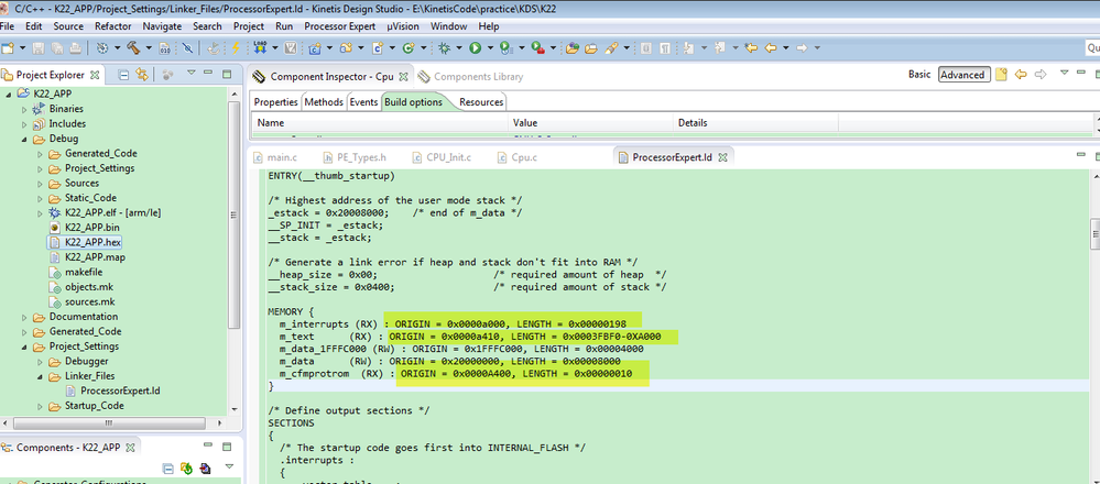

       I think it is the PE bugs, but don't worry, you can modify the ld file directly like this :
MEMORY {
  m_interrupts (RX) : ORIGIN = 0x0000a000, LENGTH = 0x00000198
  m_text      (RX) : ORIGIN = 0x0000a410, LENGTH = 0x0003FBF0-0XA000
  m_data_1FFFC000 (RW) : ORIGIN = 0x1FFFC000, LENGTH = 0x00004000
  m_data      (RW) : ORIGIN = 0x20000000, LENGTH = 0x00008000
  m_cfmprotrom  (RX) : ORIGIN = 0x0000A400, LENGTH = 0x00000010
After generate the .hex file, you can find APP is from 0xa000 like the following picture, if you still find the one line code from 0x400, you can delete it directly in the .hex file.
I attached my test bootloader and app.hex file, app function is the RED LED blink in the FRDM-K22 board.

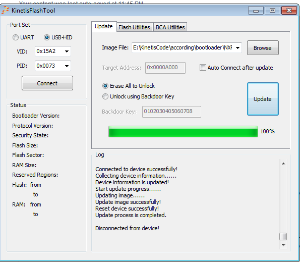

This is the test result:
After download the app.hex to my FRDM-K22 board with HID bootloader, my red led is blinking.
Wish it helps you!

   I have had no issues being able to do this on the K22-FRDM board, but should I use the FRDM_bootloader (which is for the K22FN512LH12) I am using the K22FN256LH12 chip. I have my USB attached to the same pins that K22-FRDM uses, Pins 5 and 6, but I cannot connect to my chip using the KinetisFlashTool.  I need to set my chip in some sort of bootloader mode correct? Using a reset pin maybe?
I noticed my old application code still runs after I flash my chip with the bootloader, that isn't right is it?
