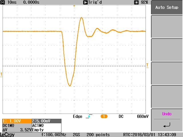

And the pulse like this.

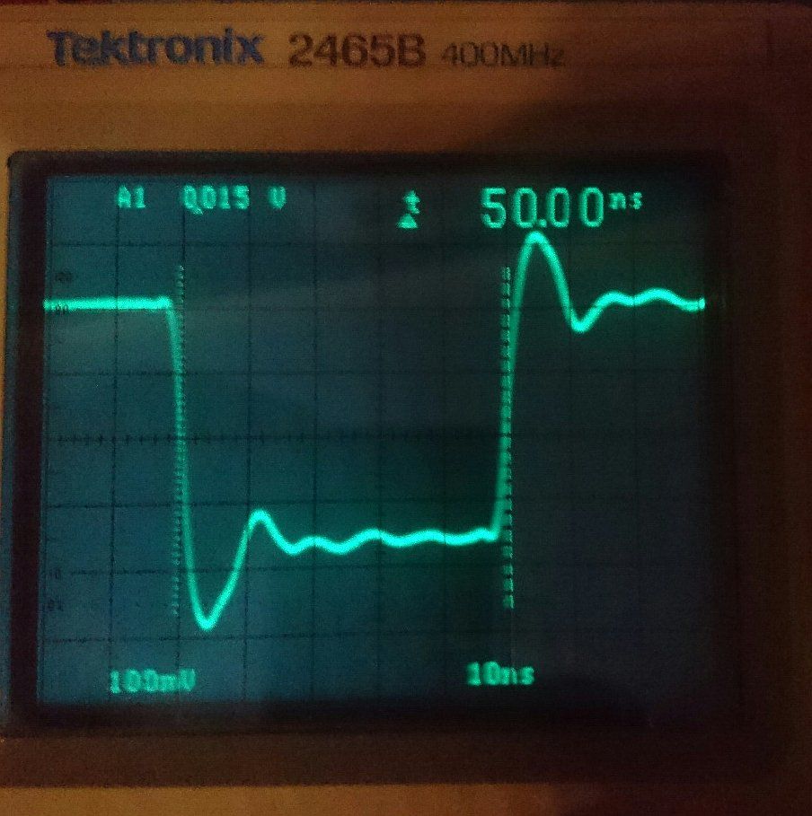

Hi Mark,
Thanks for the suggestion, it reduced the pulse width ten fold, but it is still at 50ns.
Were you running your code from RAM or using some other trick to get to 8ns?
Here is my pulse.

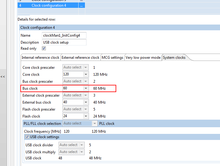

... and my clock settings
