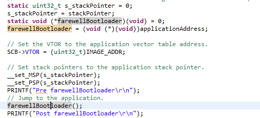

after flashing all the hex data to adresses 0x020000 and on I resetting the device and the default BL program supposed to do "Jump" to the 0x020000 section . Ive tried both options suggested in tje NXP examples:
1. direct call to void* :
2. asmembly "blx" command:
both options resetting the device right after the jump and the "Post" printf is not printed even (its directly go to "reset" sequence).
what did i do wrong? is there any special permision or special preperation i should to to the original source sotwere before compiling it or generating the Hex file?

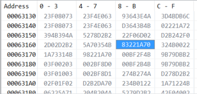

I compare the original code sequence (both the asm and even the HEX itself between the original program (line by line debugging) and there is a specific line that on the original code act OK and nothing wrong is happened and on the BL version when I get this specific line the whole code is the memory seem to be shifted if one block (16 bytes) and the addresses is not correct anymore (then the code just got lost and reset..).

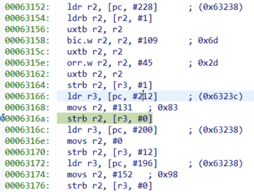

the original disasmly :

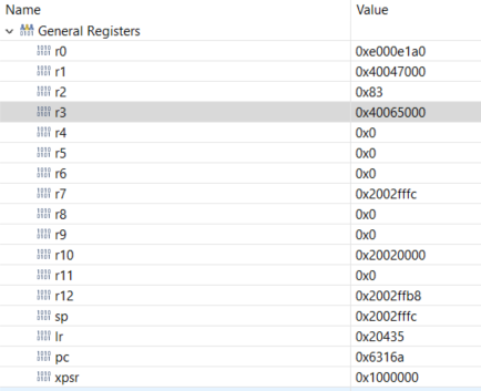

the registers original state:
Now the BL dis-assembly lines (looks the same i think): the line that makes the whole problem is 0x6316a :

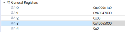

the registers before this line:

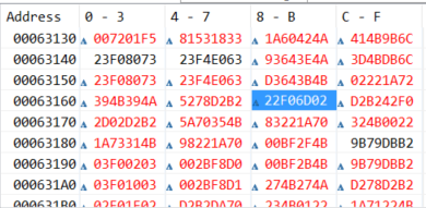

the memory before this line : the memory right after this line:
Can you understand what can be the reason for this behavior? I'm trying to debug this line by line and usually i found bug relate the HEX parser but now the code memory is looks the same so i have no idea where the bug is caused by.

This looks more like a problem with the application/start-up code that can't handle the case that a boot loader has already programmed the MCG/OSC.
