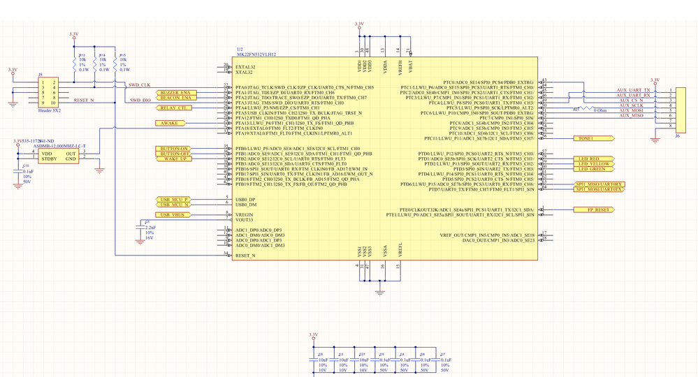

What are the minimum oscillator / crystal requirements to use the K22 SWD. I have a design that will not go into debug / flash mode

I cannot get my target to connect.  I have no external XTALS or OSC

Ok let me wrap this up.  We have pin 26 which 3.2.2.2 of the reference manual says is not NMI after reset (WRONG).  We have pin 26 of the 64 pin package  attached to an N channel mosfet with a pull down on the gate.  NMI is active so hence the jump off the rails after reset and a brief run of SWD communications.  If you look at the pin tables, the default function of pin 26 on a LQFP64 part IS NMI.  Documentation needs updates.  Also, the K22 Schematic cell for the part implies the NMI assignment implies NMI as secondary to the primary default configuration.  This needs to be observed in ALL labels applied to schematic cells when naming pins so you know from looking at the schematic what mux configurations exist in order of the pin table as in
(64 pin LQFP) pin 26 -- LLWU_P3 NMI_b/ EZP_CS_b PTA4/ LLWU_P3 FTM0_CH1 NMI_b EZP_CS_b
This way you know!

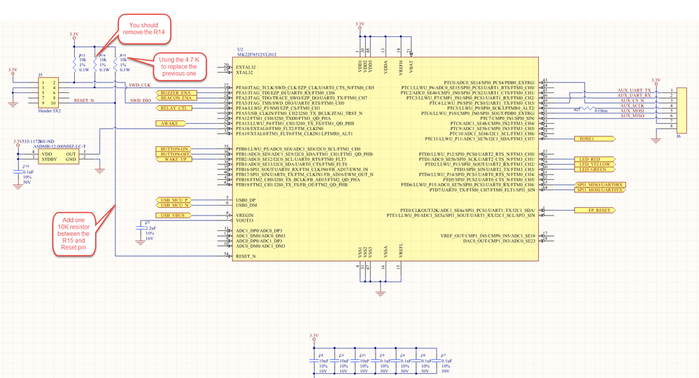

jeremyzhou
Hi Chris,
Please modify the circuit according the Fig 1, then give a shot again.
If you have any further questions about it, please feel free to contact with me.

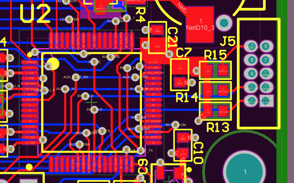

chriswestervelt
resistors r13, r14, and r15 are not populated
