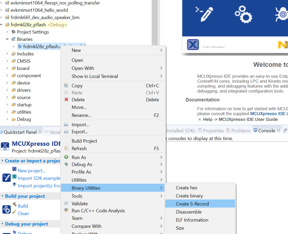

11) After build &/or during debugging, is there a way or a "tool" in MCUXpresso to do a HEX (&ASCII) DUMP that displays all parts of MKL28Z memory while display the rows & columns of the contents for address starting 0x00000000 thru 0x80000 or however I will be able to view current values from this to that address in memory?   (Similar to Windows "debug" command that displays contents of memory in your program or your PC, by default).
Thanks again for your help.

jingpan
1. yes, RODATA is ready-only data. But here you can't use __RODATA(Flash2) to declare data in Flash2. __RODATA is also data! It will be initialized when program start. This 4k space is in flash area. You can only read it. You can't write it by
