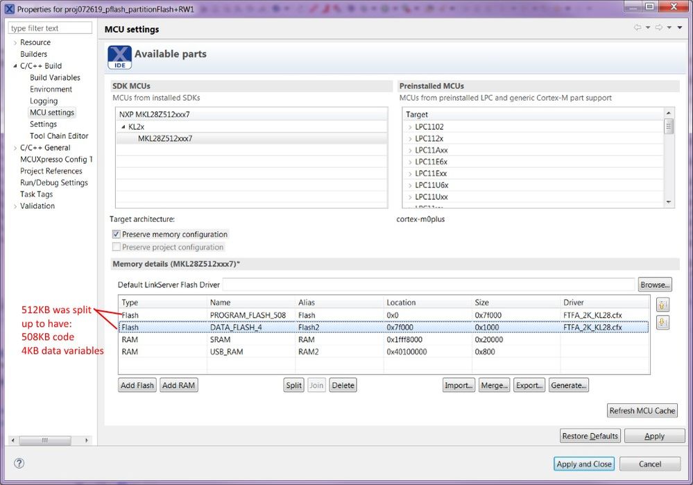

*MCU = MKL28Z512VLL7  (has 512KB flash memory built-in)
*IDE = MCUXpresso
*Debugger = PEMicro Multilink
*Custom target board
I'm starting new & separate question from previous one about writing data to non-volatile memory, specifically MKL28Z's flash memory.
(Sorry I had to take a break from this operation last 1.5 weeks because I got pulled-back to the Touch Sensing operation of the project to deal with "materials" dielectric constants surrounding our touch electrode which cause unwanted self-capacitive touch triggers, besides just finger tip touch...)
Inside MCUXpresso, this image below is my partitioned Memory details, as shown on image.   In MKL28Z, for its built-in 512KB Flash, I keep 508KB for code & just assign 4K for data variables that need to be kept in non-volatile memory for safe-keeping in case of power failure, we don't want to lose latest measurements data.
Technical support mentioned about using a macro called,  _RODATA(Flash2), to define a variable in that section.
This is not self-explanatory to me given an example post about this as also stated on MCUXpresso IDE User Guide.  It is not clear because if I read their statements literally which mention "constant", then that says to me that "RO" means "read-only".  (see https://community.nxp.com/thread/389102)
Questions:
1) Does the "RO" in RODATA mean "read-only"?   I need my variables to be changeable to different values that can be updated whenever statistical measurements of the system are gathered periodically.
2) The posted discussion did not provide the "memory map" as I showed on image above.  And they say some other or additional flash memory block added from other external flash or block.   I got 2 flash sections by simply splitting up what used to be all 512KB  "PROGRAM_FLASH_512" & Aliased "Flash" and changing the address & size range accordingly.   Is their discussion applicable & similar anyway to my situation?
3)  Having no memory map shown like my image above, I'm not sure if the Alias term, "Flash2" is coincidental as used in _RODATA(Flash2).   If "Flash2" is exactly whatever alias or name was assigned for the "other or new" flash memory area to be used for data (or function as posted), then I guess I should also use "Flash2" as in _RODATA(Flash2) ...?
4) The post stated to include as:
#include <cr_section_macros.h>
Include where?  In my own header .h or source .c file?
5)  If so, with _RODATA(), there is no need for me to hardcode or program any #definition like starting & ending address of my Flash2 data section in flash?
E.g.
#define  DATA_FLASH_4_START_ADDR   0x0007F000U
#define  DATA_FLASH_4_ENDING_ADDR   0x0007FFFFU   (correct?  or less 4-byte alignment must be 0x0007FFB ?)
6) Without the need for hardcoding direct address definitions of start & ending address for that section in flash, does defining a string will automatically put that string definition inside Flash2 section without worries?
 _RODATA(Flash2) char str[] = "hello world\r\n";
7) Where does flash memory "protection" and "secured" settings come into play in all these?     During flash (code) programming, I don't want my stored data in Flash2 to be erased or overwritten.   Should I be setting up FPROT registers for that area in memory to prevent my data area from being deleted or corrupted?  Where in code should I set FPROT registers to protect my data flash area from flash erase & programming (inside MCUXpresso or external flash IC programmer)?
8) MKL28Z flash memory is 2KB size sectors.    To write values to the flash data area, a whole 2KB section first needs to be erased & verified as erased.    However, I may already have some previously saved data values within that sector even though I'm only changing one of the variables now, which so happen to have a size of 1 byte only.  The best practice for this situation would be during program initialization when data variables are placed in RAM space (.data or .bss, initialized or zeroed out).    How do I make "a copy" of my data (2K+2K=4K) from Flash2 be copied in RAM space for volatile fast access?  And so when it's time to save an update to one of the bytes or word variables to non-volatile flash, AFTER ERASE of 2KB sector, I can RESTORE all the full 2KB values from RAM & write them to flash.  Is that correct method to do this?

jingpan
1. yes, RODATA is ready-only data. But here you can't use __RODATA(Flash2) to declare data in Flash2. __RODATA is also data! It will be initialized when program start. This 4k space is in flash area. You can only read it. You can't write it by
"foo=0x11;"
This will cause hardfault! You split flash in software level, not in hardware level.
If you declare it as a __DATA() or __BSS(), initialize code will try to write something into it also.
You can only declare as "__TEXT(Flash2)".
2. you can do that. No problem.
3. Flash2 is alias of DATA_FLASH_4. They are same. Both __RODATA(Flash2) and __RODATA(DATA_FLASH_4) is correctly. But again, you can't use __RODATA(Flash2).
4. When you use __RODATA() or __BSS() or __NOINIT(), you should add this line in the file.
5,6. You can define
This will not affect compiler. You can read Flash2 by pointer. You can program Flash2 by FLASH_Program() function. Defining DATA_FLASH_4_ENDING_ADDR to 0x0007FFFFU has no meaning to hardware or compiler. It only has meaning to you. You know if you read or write over this limit, hardfault will happen. If you have (*(unsgiend int*)DATA_FLASH_4_ENDING_ADDR)=xx, alignment hardfault will also happen.
7. "Secure" means all flash memory can't read/write from external port. "Protection" means individual regions within the flash memory can be protected from program and erase operations. If you set FPROT, you can't erase/write it anymore. It seems conflict with question 1.
8. Kinetis flash cycling endurance minimum is 10k. That means you can only erase-write 10k times. If the erase-write operation is in a low frequency, it is fine. But if you often do it, you must take it into consider.
I made a demo to show how to use Flash2. You can see that I declare a __TEXT(Flash2) address variable, print it, then modify it by flash erase/write function. Then print it again. It will print out new value.
