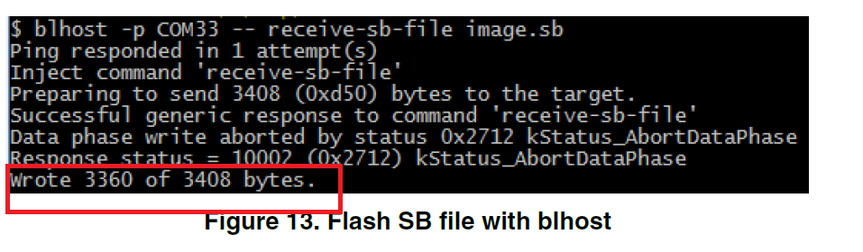

However - when I run the blhost.exe 'receieve-sb-file' command - the sb file seemingly fails to flash the last 32 bytes:
blhost.exe -u -- receive-sb-file agent-poc.sb
Inject command 'receive-sb-file'
Preparing to send 23648 (0x5c60) bytes to the target.
Successful generic response to command 'receive-sb-file'
usb hid detected receiver data abort
Data phase write aborted by status 0x2712 kStatus_AbortDataPhase
Response status = 10004 (0x2714) No response packet from target device.
Wrote 23616 of 23648 bytes.

jingpan
Hi john,
I think this is not a problem. Please look at page26 figure 13 in Kinetis Bootloader QuadSPI User's Guide.pdf.
I guess this is because data in sb file is orgnized in block. The last block will be filled with useless data.
Jing
