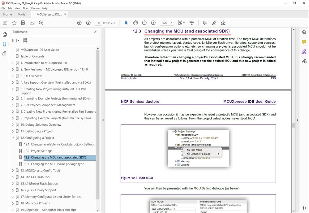

I have programmed for MKV30F128VLF10. And later I have replaced MKV30F128VLF10 with MKV30F64VLF10 in hardware. Now I need to make changes in program for MKV30F64VLF10.
Is that possible?
If yes, then how?
Software tool used- MCUXpresso IDE
hari.

Hi hari,
Please refer the "12.3 Changing the MCU (and associated SDK)" of MCUXpresso_IDE_User_Guide.(C:\NXP\MCUXpressoIDE_11.4.0_6224)
12.3 Changing the MCU (and associated SDK).jpg12.3 Changing the MCU (and associated SDK).jpg
Robin
