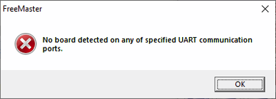

The issue I am having is that I am unable to monitor the project with FreeMaster 3.1. I used PMSM_Sensorless_FOC.pmp file and when I click on the GO button I am getting this error
From KDS I am able to connect to the board with the same com port, so I know the com driver is working. Please help to get the FreeMaster 3.1 to monitor and control the BLDC motor.

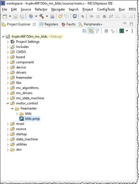

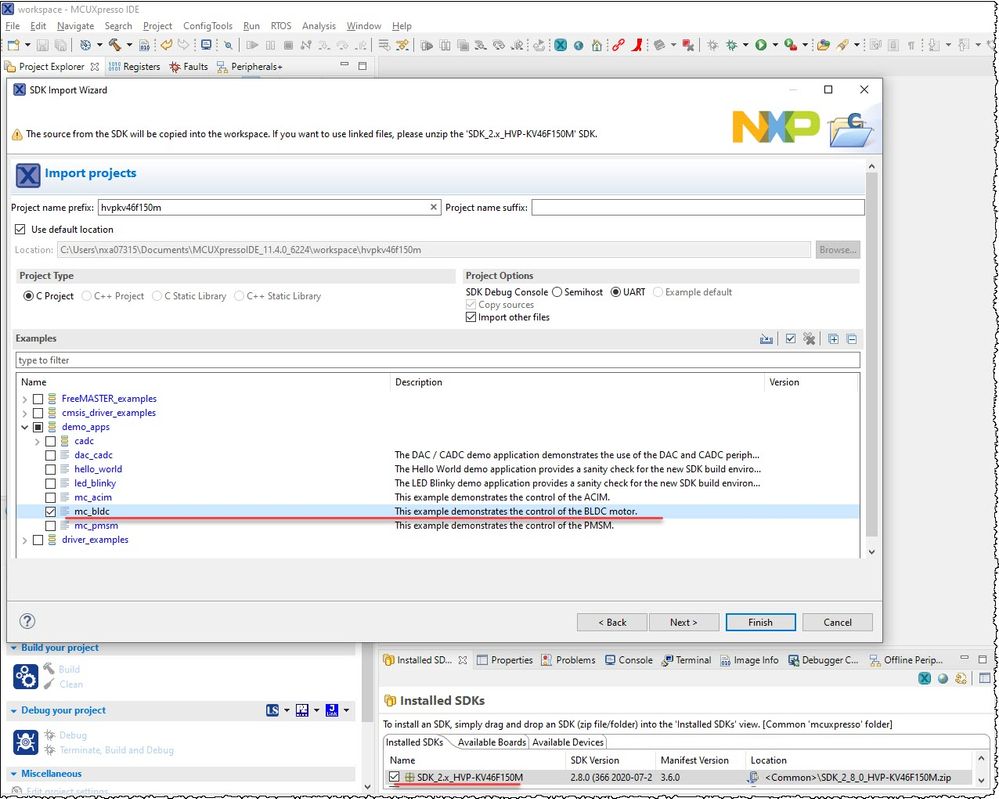

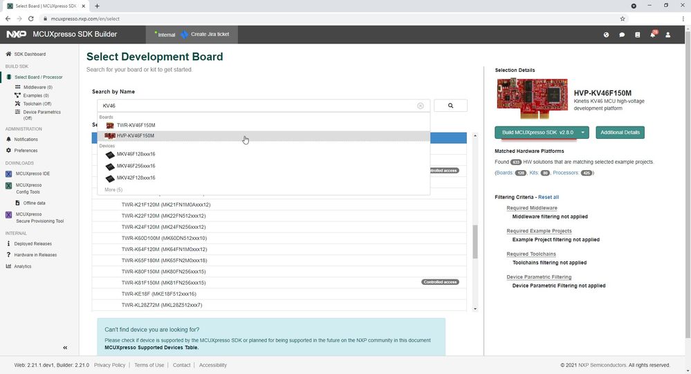

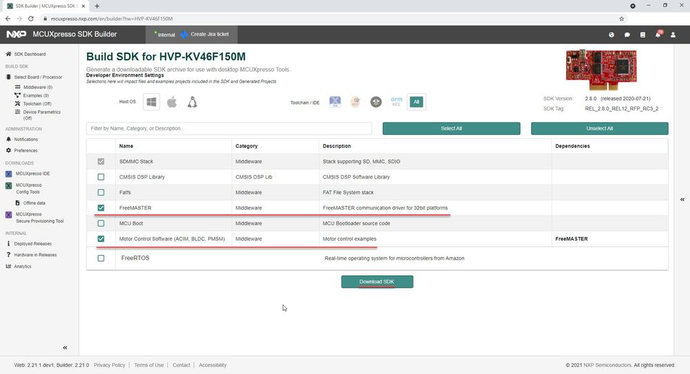

MCUXpresso SDK and IDE are recommend.(KDS is too old)
