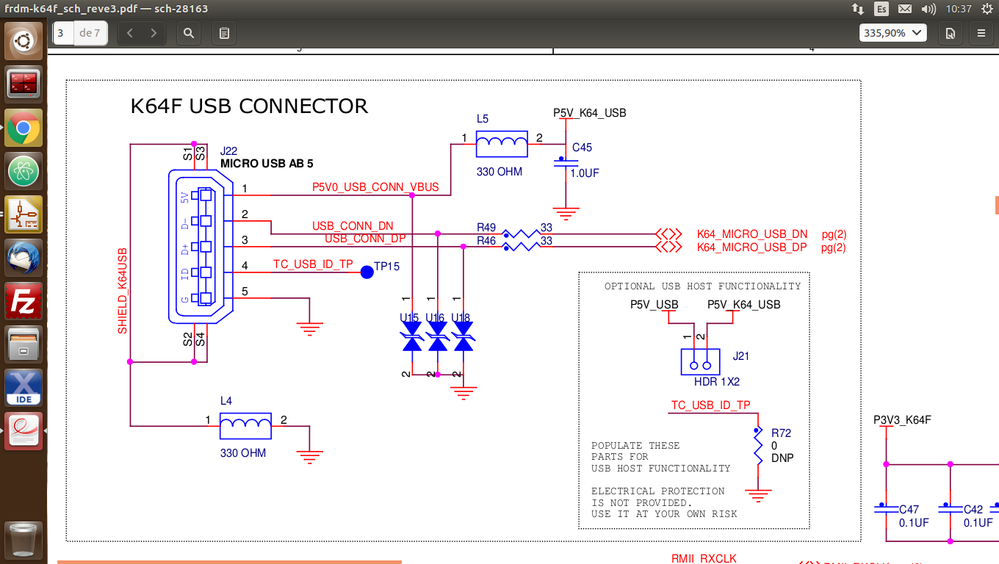

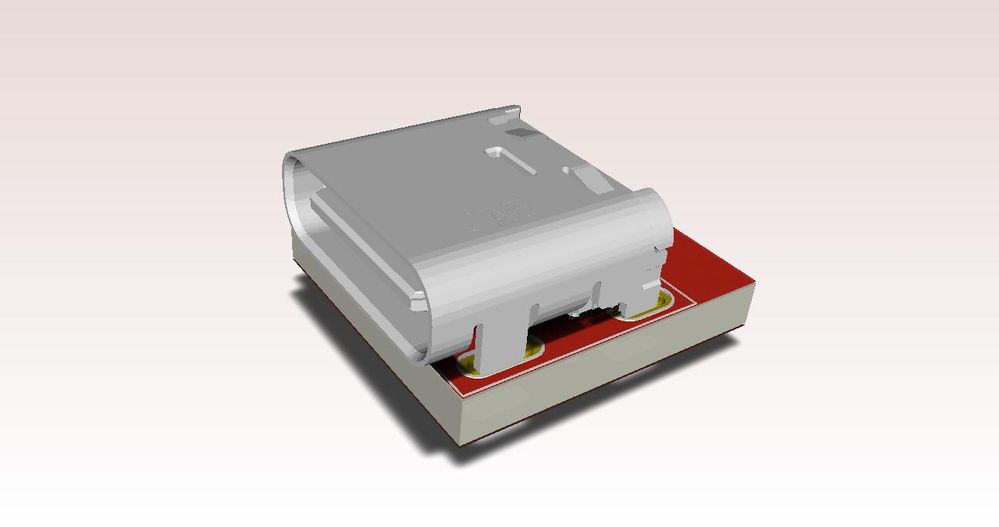

I'm trying to connect this USB C connector JAE-DX07S024JJ3R1300  with the Kinetis K26.
I just want to use USB 2.0 interface.  If I don't use SuperSpeed Data Path (TXn+,TXn-, RXn-,RXn+) , Configuration Channel CC1 and CC2, Sideband Use SBU1 and SBU2, I have to leave the pins floating?
L4 and L5 are 330OHM or 330UH ? I'm confused by this  Is not that an ferrite fixed inductor?
What New and Active Nexperia TVS I can used to U15, U16 and U18 ?

Per USB Type-C spec 1.2, the unused pins can be left unconnected.
for the L4,L5 used in FRDM-K64F, please kindly refer to the attached BOM.
Hope that helps,
Kan
