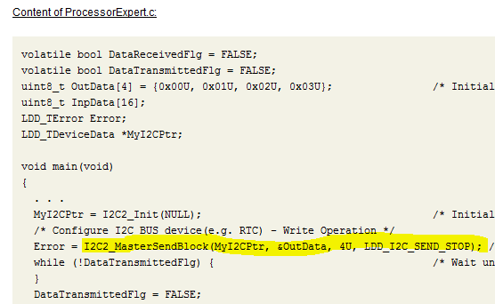

If you look at typical usage for the component, you see this example below and then the prototype of the real component.  Why are they different?
But in my CW 10.3 it seems the component is different, in fact there are only 3 parameters to pass.
byte I2C2_SendBlock(void* Ptr, word Siz, word *Snt);

Hi Steven,
I think you compare methods of two different components: Internal2C component which implements SendBlock method and I2C_LDD which has MasterSendBlock. Am I right?
Lukas

steve_fae
Senior Contributor I
I figured that out after posting but couldn't find how to retract my post.  Thanks
