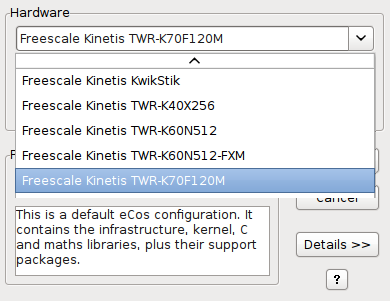

Configuring eCos for Kinetis
Start the graphical configuration tool configtool, then from menu select Build->Templates. In Hardware selection box select your board:
In our case we select TWR-K70F120M.
Save the configuration and select Build->Library. configtool will build a customised eCos library and extract headers for you.
Now you are ready for your "Hello world".

I have downloaded latest eCos from their website. Don't see Freescale TWR-K60N512 in the config tool hardware list.
Can you please post where you found this information?
eCos for Kinetis is available from eCos CVS repository.
Here you will find information for CVS access and download: http://http://ecos.sourceware.org/anoncvs.html
