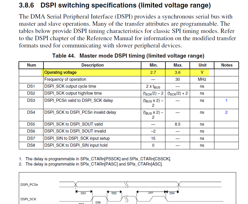

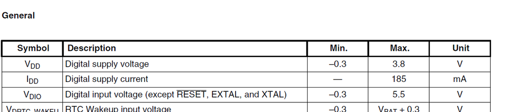

3.3V Power for MK64FN1M0V serires MCU, The digital max input voltage can be 5.5V.
Can it compatible with 5V level SPI commmunication?
1,258 Views
kerryzhou
Hi johnson zhang ,
   From the K64 datasheet, you can find the SPI have the limited voltage range:

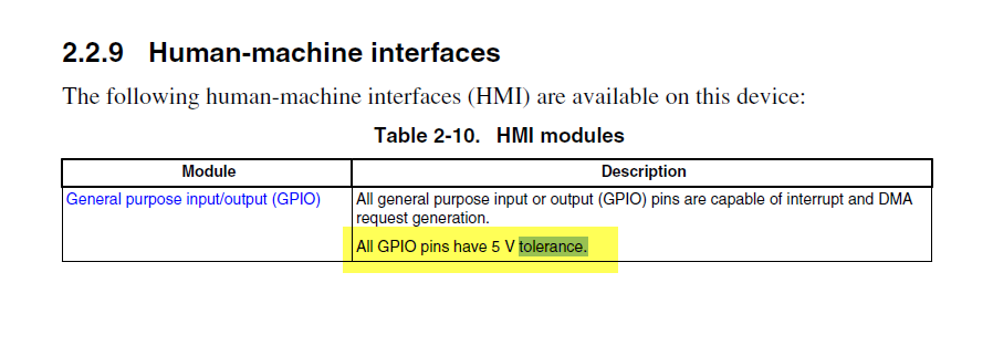

But to the GPIO pins, all the GPIO pins is 5V tolerance.
Wish it helps you!
