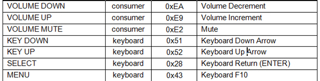

As per my requirement,I need to send functions(for eg:volume up/down/mute) in Keyboard usage page and some in Consumer usage page(as given in the below table) in the same BLE HID code to control the phone.  So, I tried to implement both the usage pages in one report map and It worked for functions implemented in consumer usage page, but unfortunately it doesn't work for functions implemented in keyboard usage page.
I used the HID codes given in the following link: http://www.freebsddiary.org/APC/usb_hid_usages.php.  Please, provide some solution to make it work for combined keyboard and consumer usage pages.

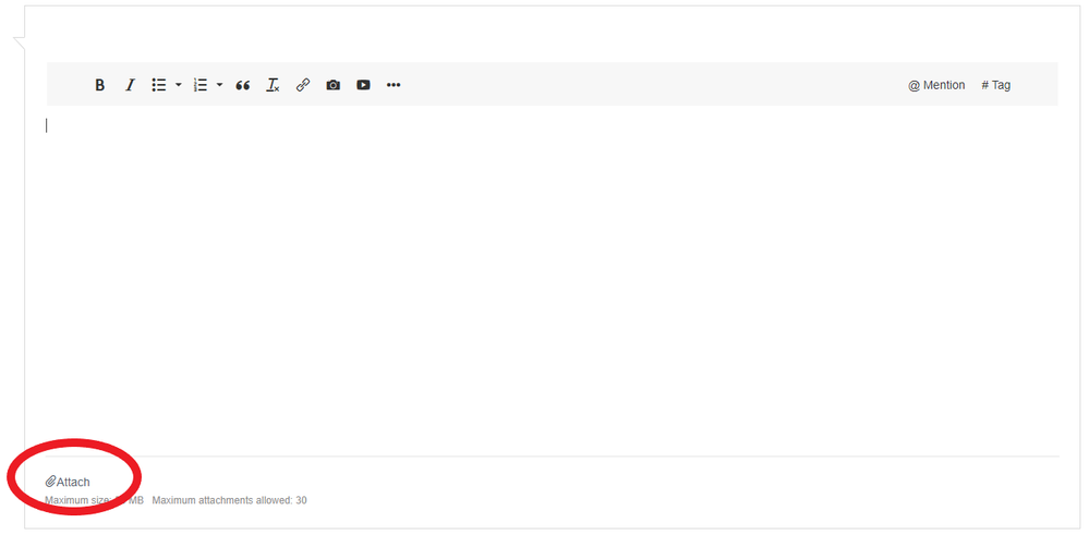

To attach an archive, you have to click on the "Advanced Editor" button when creating a reply, you'll see the option there.

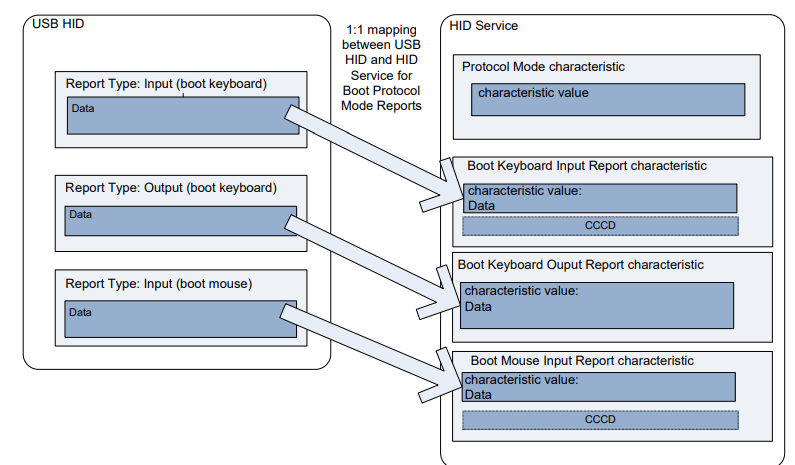

With the provided information, I think that maybe the problem lies with the registration of your multiple reports. It seems like each device needs a separate Report I/O Characteristic.
The BLE HID Service document shows some diagrams explaining this:
This diagram here also shows the mapping from USB HID to the HID service used by BLE. Could you please take a look at the HID service document found here and compare with the implementation in the HID device example provided?
Also, it may be useful to you to compare with an HID USB example implementing an HID composite device, like the one included in the K64's SDK. That one might be a good reference for what you're trying to do.
