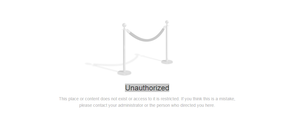

mesdouaabderraz
Hello, bmwhui‌
thank you for your replay, but i can't access to the first link that you sent mepastedImage_1.png
can you please Provide me another link,
Also, I have always the problem of connection SPI interface on my fingerprint tcesc4k, i can't  configure him as SPI bus slave (CPOL = 0, CPHA = 0).
