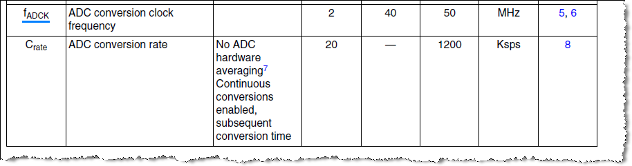

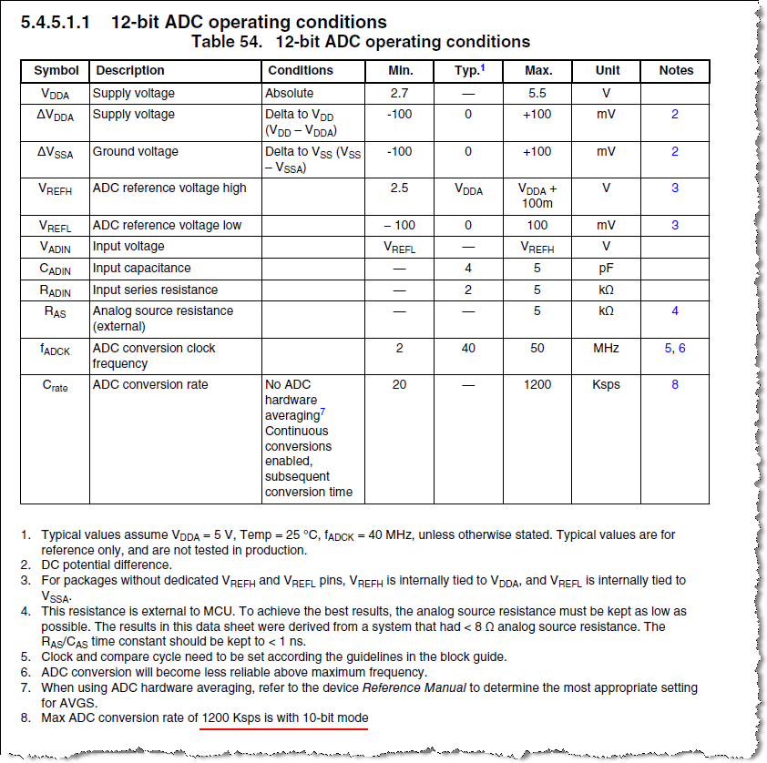

The 1200Ksps ADC conversion rate is for 10-bit mode(No ADC hardware averaging Continuous conversions enabled, subsequent conversion time)

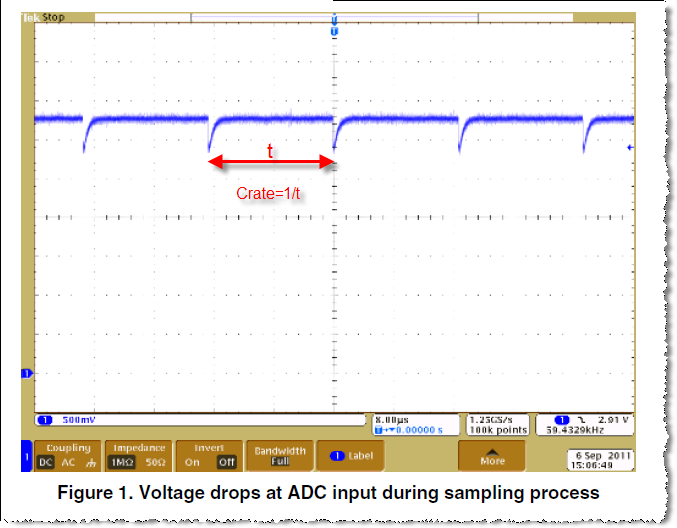

And measure the "Voltage drops at ADC input during sampling process" to test the ADC conversion rate.

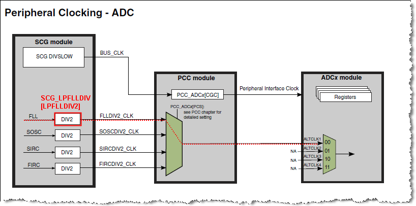

For my application I cannot use the continuous mode. Also I’m using the bus clock as the ADC clock and as a result the SCG_LPFLLDIV[LPFLLDIV2] should not affect the ADC clock.

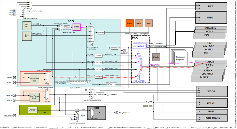

I am afraid you have select the SOSC_CLK as the ADC clock.
The frequency of SOSC_CLK depends on the external crystal oscillator.
The frequency of FLL_CLK may faster than SOSC_CLK.
You can have a try to select the FLL_CLK as the ADC clock:
CLOCK_SetIpSrc(kCLOCK_Adc0, kCLOCK_IpSrcLpFllAsync);//LPFLL async clock
Robin

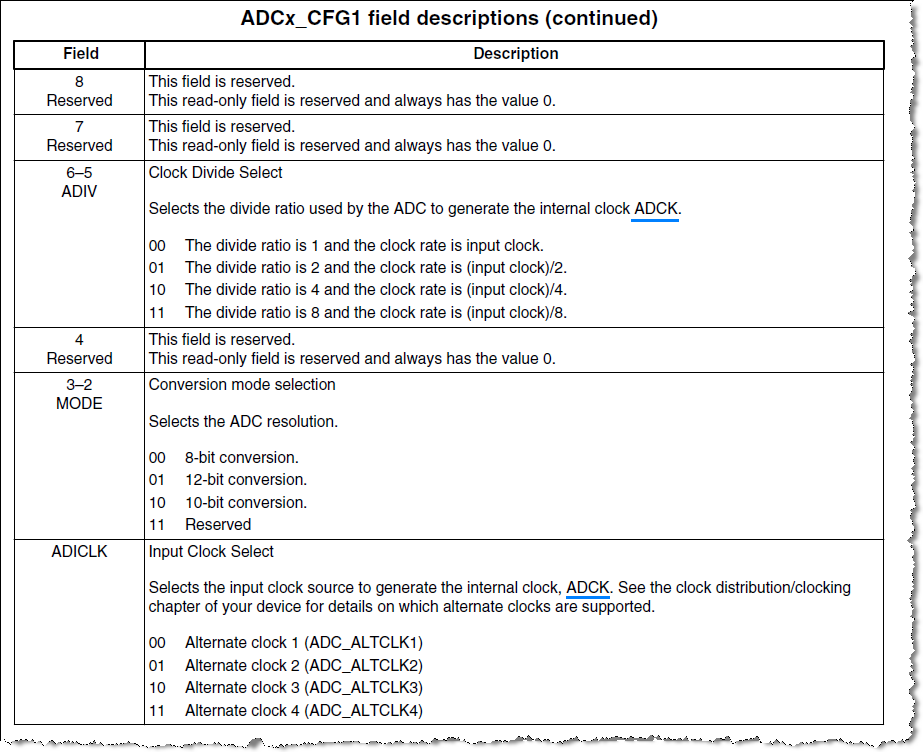

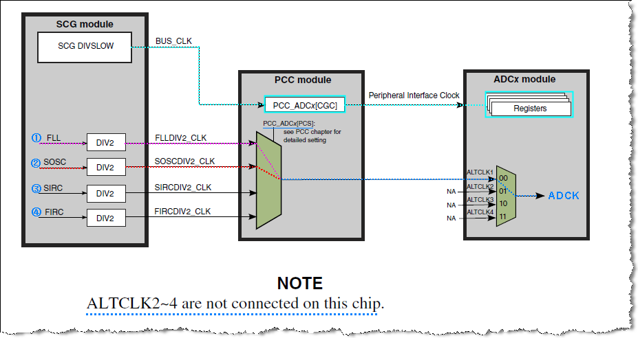

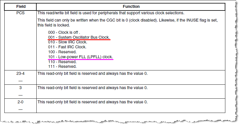

I don't know how you select the bus clock as the clock source for fADCK. The bus clock is for the registers of ADC module.
There are only four clock sources can be selected as fADCK:
00 Alternate clock 1 (ADC_ALTCLK1)
01 Alternate clock 2 (ADC_ALTCLK2)
10 Alternate clock 3 (ADC_ALTCLK3)
11 Alternate clock 4 (ADC_ALTCLK4)
ALTCLK2~4 are not connected on this chip. So you can only select 'Alternate clock 1 (ADC_ALTCLK1)' as fADCK.
There are only four clock sources for 'Alternate clock 1 (ADC_ALTCLK1)' which act as fADCK:
①FLL_CLK
②SOSC_CLK
③SIRC_CLK
④FIRC_CLK
If you configure PCC_ADC0[PCS]=001 - System Oscillator Bus Clock. Then ②SOSC_CLK is selected as fADCK.
The frequency of ②SOSC_CLK is depends on the external crystal. I am not sure if you are using 24MHz crystal.

From the chart you sent to me, the frequency of SOSC_CLK depends on the external crystal. The EXTAL frequency on my board is 8 MHz, only 1/3 of 24 MHz. And this explains why my measured conversion speed is about 6 us instead of 2 us as calculated.
