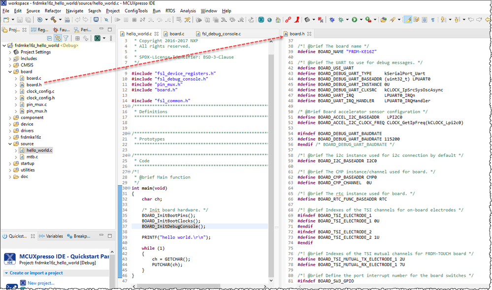

I am using KE16Z64VLD4 MCU for my application and using MCUXpresso IDE and  SDK_2.x_FRDM-KE16Z SDK. but code is stuck in
 BOARD_InitDebugConsole();     >>     DbgConsole_Init(BOARD_DEBUG_UART_INSTANCE, BOARD_DEBUG_UART_BAUDRATE, BOARD_DEBUG_UART_TYPE, uartClkSrcFreq);    >>  assert(kStatus_SerialManager_Success == status);
How to solve this ? and I want to use Debug console so, it is necessary to solve the problem.

#define BOARD_DEBUG_UART_CLKSRC kCLOCK_IpSrcSysOscAsync in board.h, but Problem in initialization of clock you don't have external crystal.
BOARD_DEBUG_UART_CLKSRC   kCLOCK_IpSrcSysOscAsync.pngBOARD_DEBUG_UART_CLKSRC kCLOCK_IpSrcSysOscAsync.png
Would you please check difference between the your custom board and FRDM-KE16Z?
For example:
LPUART0 is used?
PORTB0 (pin 27) is used as LPUART0_RX?
PORTB1 (pin 26) is used as LPUART0_TX?
Robin

Yes, I have check it is same as KE16Z. I also go through UART SDK example but, didn't find the solution. Further support is required.

Thank you for this solution. Now, I'm using SIRC(4MHz) as a clock source for debug console but, PRINTF function is not working although code is running nicely and having 0 errors and 0 warnings. I assigned LPUART0 for debug console. Attaching Screenshots.
