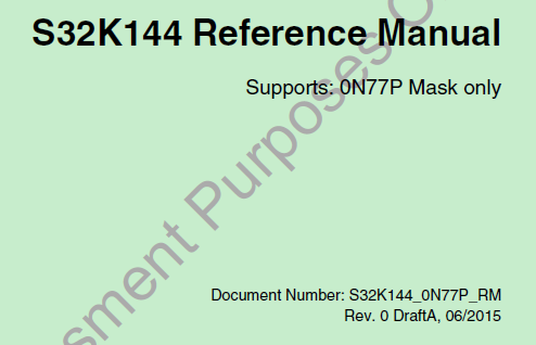

Could you let me know which version of S32K144 reference manual  file you are using?
I check the S32K144 RM, the LPTMR clock source was controlled by PCC LPTMR0 register.
Customer need select the OSCCLK in PCS bits of PCC_LPTMR0 and configure LPTMR0_PSR register to get 1KHz clock.
The K60 product using SIM register to control clock enable to LPTRM module, while S32K144 using PCC_LPTMR0 register to control module clock enable.
Wish it helps.

yashkumar
can you provide me reference manual here S32K144RM revision version 1 or any link where i can get it. I had tried but not found any where .
Thanks!
5,075 Views
Hui_Ma
The S32K144 product is not released so far. The related reference manual need to sign NDA agreement at first.
So, please contact with your local NXP distributor about NDA agreement issue.
Thank you for the understanding.
Wish it helps.
Ma Hui

Hui_Ma
The LPTMR is capable of triggering each ADC via TRGMUX. The TRGMUX ADC registers default value is trigger source disabled.
Each module has related interrupt enable bit, for example Low Power Timer Control Status Register (CSR) [TIE] bit control if the LPTMR interrupt enable or disable. While, it also need to enabled related interrupt at NVIC.
If you could contact with your local NXP FAE/Sales to get S32K144 Reference Manual of Preliminary - 0N77P Mask document (NDA agreement)?
If so, you could find the whole interrupt vector assignments table at Table 3-4 of below reference manual:
Wish it helps.
Ma Hui
