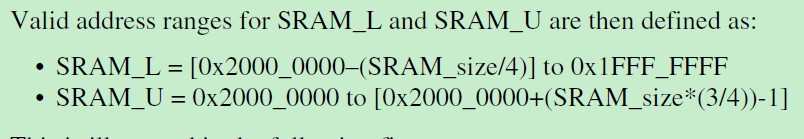

    Maybe it caused by your RAM range define, or the RAM overflow.
   You said, you get the warning:Target inconsistency detected in Memory range 0x1FFFF800-0x1FFFF807
  As you know, the KL03 32k just have 2KB RAM,
So, the RAM range is :
SRAM_L = 0X1FFFFE00~0X1FFFFFFF
SRAM_H=0X20000000~0X200005FF
0x1ffff800-0x1ffff807 is out of the KL03 32K RAM size.

After reading your answer I switched to using the file "FlashKLxx2K.out".**  You pointed out that there was only 2Kbyte of RAM on the KL03.  After that I was able to upload the flashloader and eventually my applicaion.
-thanks
** I believe this is an IAR maintained file normally located in this directory:
C:\Program Files (x86)\IAR Systems\Embedded Workbench 7.3\arm\config\flashloader\Freescale
