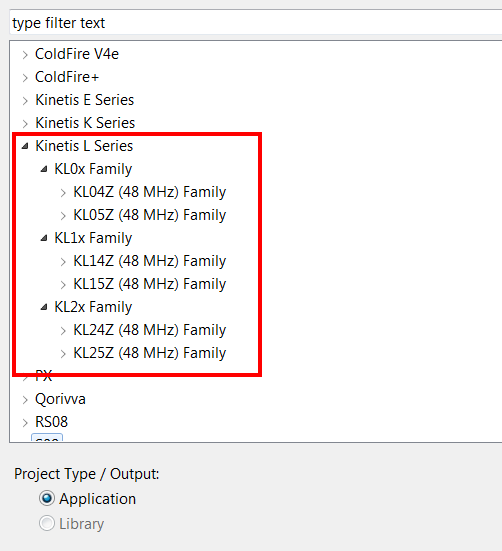

Hello:
I have just received a FRDM-KL25Z evaluation board, and downloaded a version of Code Warrior to use as an IDE for it (I downloaded the beta version).  This version of CW does not seem to support any of the L series Kenetis processors.   I've used CW on other projects a few years ago, and would like to continue to do so now if it is possible.
Could anyone point me to a version of CW that will allow me to evaluate the KL25Z?
6,527 Views
LuisCasado
Hello Curt,
CW 10.3 Beta does support Kinetis-L. Just try to create a new project and you will see the supported devices in the wizard:
Luis

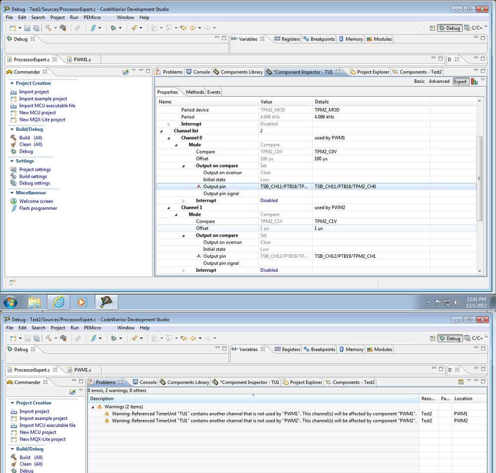

I am having trouble setting up 2 PWM channels using TPM2_CNT. When I try to configure
the second channel on the TPM2 it gives out an error.
Kesara De Costa

kesaradecosta
I have managed to configure the TPM2_CNT with 2 PWM channels running at 5kHz but with warnings see the attachment.
Kesara
6,527 Views
BlackNight
Hi Kesara,
I only used on ultrasonic module (Tutorial: Ultrasonic Ranging with the Freedom Board).
But I see these warnings too, and have reported them to the engineering team.

LuisCasado
Hello Curt,
Luis
6,527 Views
tom_thompson
The CodeWarrior for MCUs v10.3 beta is available from this web page, which is different from the standard CodeWarrior download page.
---Tom
