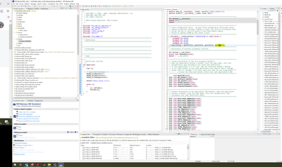

I have an MKE04Z8 and use Keil to program it. The MKE04Z4_DFP Package have Version 14.0.0.
How can I turn on the code readout protection in the device?
Here is what I tried:
When I try to set the read out protection the MCU does not start anymore. I tried the following:
In "startup_MKE04K4.S" I altered the flash config from
/* Flash Configuration */
.section .FlashConfig, "a"
.long 0xFFFFFFFF
.long 0xFFFFFFFF
.long 0xFFFFFFFF
.long 0xFFFDFFFF
.text
.thumb
Where's my mistake?

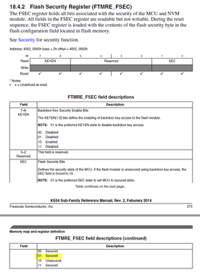

As you change the flash configure from .long 0xFFFEFFFF to .long 0xFFFDFFFF, it means that only the FTMRE_FSEC register has chnanged, especially, SEC bits change from 10 in binary(unsecure mode) to 01 in binary(secure mode). After reset, the chip is in secure mode, the SWD port is blocked, you can not read code/data from SWD port.
But the secure or unsecure mode does NOT take effect on the chip running.
As a test, after you restore to unsecure mode after mass erasing and redownloading, can the KE04 run fine again?
