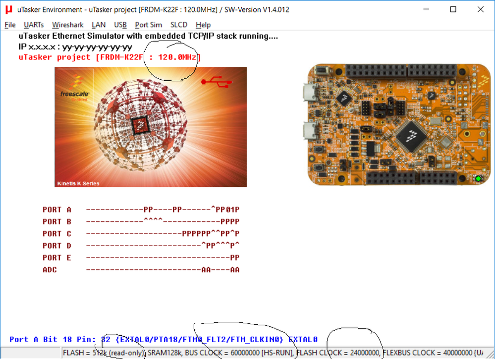

Yes, all looks to match. Note that the divider in the PLL is in the "feedback path" and this has the effect of a multiplier on the output frequency. I think you just need to somehow get the PLL to multiple by 30.
Here is the code that I use for HSRUN at 120MHz on this board and I have written the exact hex values written to the registers as reference:
MCG_C2 = (MCG_C2_FREQ_RANGE | MCG_C2_GAIN_MODE | MCG_C2_EREFS | MCG_C2_LOCRE0); // [0x94] select crystal oscillator and select a suitable range
MCG_C1 = (MCG_C1_CLKS_EXTERN_CLK | MCG_C1_FRDIV_VALUE);              // [0x98] switch to external source (the FLL input clock is set to as close to its input range as possible, although this is not absolutely necessary if the FLL will not be used)
_WAIT_REGISTER_FALSE(MCG_S, MCG_S_OSCINIT);                          // loop until the crystal source has been selected
_WAIT_REGISTER_TRUE(MCG_S, MCG_S_IREFST);                            // loop until the FLL source is no longer the internal reference clock
while ((MCG_S & MCG_S_CLKST_MASK) != MCG_S_CLKST_EXTERN_CLK) {}      // loop until the external reference clock source is valid
MCG_C5 = ((CLOCK_DIV - 1) | MCG_C5_PLLSTEN0);                        // [0x21] now move from state FEE to state PBE (or FBE) PLL remains enabled in normal stop modes
MCG_C6 = ((CLOCK_MUL - MCG_C6_VDIV0_LOWEST) | MCG_C6_PLLS);          // [0x46] set the PLL multiplication factor
while ((MCG_S & MCG_S_PLLST) == 0) {}                                // loop until the PLLS clock source becomes valid
while ((MCG_S & MCG_S_LOCK) == 0) {}                                 // loop until PLL locks
SIM_CLKDIV1 = (((SYSTEM_CLOCK_DIVIDE - 1) << 28) | ((BUS_CLOCK_DIVIDE - 1) << 24) | ((FLEX_CLOCK_DIVIDE - 1) << 20) | ((FLASH_CLOCK_DIVIDE - 1) << 16)); // [0x01240000] prepare bus clock divides
SMC_PMCTRL = SMC_PMCTRL_RUNM_HSRUN;                                  // [0x60] set high speed run mode (restrictions apply) so that the clock speeds can be obtained
MCG_C1 = (MCG_C1_CLKS_PLL_FLL | MCG_C1_FRDIV_1024);                  // [0x28] finally move from PBE to PEE mode - switch to PLL clock
while ((MCG_S & MCG_S_CLKST_MASK) != MCG_S_CLKST_PLL) {}             // loop until the PLL clock is selected
Simulation below showing the frequencies that result.

I don't use the configuration tools, but these are the HSRUN mode settings I use on the FRDM-K22F for 120MHz CPU speed:
        #define CRYSTAL_FREQUENCY    8000000   // 8 MHz crystal on board
        #define USE_HIGH_SPEED_RUN_MODE        // operate in high speed RUN mode - note that flash programing is not possible in this mode so NO_FLASH_SUPPORT should be enabled in config.h
        #define CLOCK_DIV            2     // input must be divided to 2MHz..4MHz range (/1 to /24)
        #define CLOCK_MUL            30    // the PLL multiplication factor to achieve operating frequency of 120MHz (x24 to x55 possible) - > 80MHz requires high speed run mode, which doesn't allow flash programming
        #define FLEX_CLOCK_DIVIDE    3     // 120/3 to give 40MHz
        #define FLASH_CLOCK_DIVIDE   5     // 120/5 to give 24MHz
        #define BUS_CLOCK_DIVIDE     2     // 120/2 to give 60MHz
So if you are presently getting 80MHz you need to find a way to change the clock multiplication value (within its possible range). Probably it is giving you an input divide of 4 and multiplication of 40  so you need to change the divider to 2 and mul to 30 as above. See the following if you are not familiar with the MCG:
