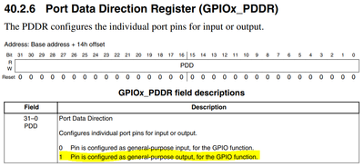

Also, you can verify that the pin is getting toggled by debugging the project and reading the value of the PDOR register of the GPIO here:
Best Regards, Miguel.

This is how I configured and while checkingusing peripherals window, I can see like this
I added breakpoints at the Toggle function and resumed but the value is zero always.

However, on the image you shared with me the PDDR register has a value of 0x0 and the spected value is 0x80 (bit 7 set to 1).
Please you confirm if this isn't the issue.
