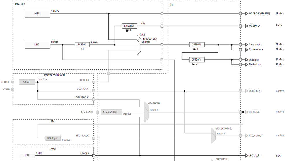

aboss
Mark,
I am using a core frequency of 48 MHz:
Per your recommendation, I am now using the fast GPIO address and writing to the PTOR register. Based on the above clock mapping, I am seeing a GPIO toggle of ~332 ns (8 bus clock cycles). My code is:
