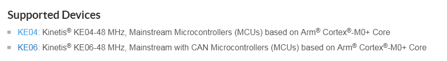

hello everyone,
I'm using the FRDM-KE06Z to program an external processor. in NXP web site, shows that this freedom board supports KE04. like the picture below.pastedImage_1.png
When i try to program my MCU, the 17926 error happens,
My question is simple, could this board FRDM-KE06 program an extern KE04 processor?
note: i've removed the Resistor R58 SWD_CLK.
thank you my friends.

Hi GABRIEL CAMARGO,
    Please change your FRDM-KE06Z on board debugger to JLINK, then debug your KE04 again.
    The JLINK firmware can be found from this link:
SEGGER - The Embedded Experts - Downloads
   About how to change the on board debugger firmware, please refer to this link:
OpenSDA Serial and Debug Adapter | NXP
   But please note, the FRDM-KE06 JLINK firmware have this limit:
  1. The firmware is only to be used with Freescale target devices. Using it with other devices is prohibited and illegal.
  2. The firmware is for use with evaluation boards only. It is not for use with custom hardware.
  3. The firmware may only be used for development and/or evaluation purposes. It may not be used for production purposes.
  4. The firmware is made available without any warranty and without support.
Wish it helps you!

Thank you Kerry Zhou,
I followed these steps above and now i can debug my KE04 processor by J-link.
Gabriel
