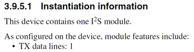

I'm looking for clarification on the I2S/SAI configuration on the K22DX256, namely the number of I2S transmitter channels.
Page 124 of the reference manual says the device includes one I2S:
Page 194 shows two TXD lines:
Which of these is correct?

As you said that the K22 has ONE SAI module, each SAI module has two transmitter pins I2S0_TXD0/TXD1 and two receiver pins I2S0_RXD0/RXD1.
In I2S mode, each transmitter pin can transfer two channels, so two transmitter pins can transmit 4 channels.
Hope it is helpful

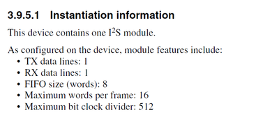

That seems to be at odds with what the manual says, though:
If the K22DX256 does indeed have a second transmit line that would be wonderful news because I could use it for a project I thought it wouldn't be suitable for. I just don't see any indication that the second TX line exists aside from the entry in the pinout table. The debugger only shows one "I2S0_TDR", and MK22D6.h only lists I2S0_TDR0.

I am sorry, the SAI module of  K22DX256 just has one transmitter pin I2S0_TXD0 and one receiver pin I2S0_RXD0.
Pls refer to section 3.9.5.1 Instantiation information in K22P48M50SF4RM.pdf, which is RM of MK22DX128VLF5, MK22DX256VLF5.
The SAI transmitter/receiver pins are dependent part number for the same K22 family, some has 1 pin for each transmitter and receiver, some has 2 pins for each transmitter and receiver.

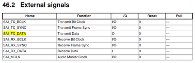

So the pinout information is wrong, correct? I couldn't find any newer revisions or documentation errata.

I suppose that the pin out information is wrong for K22DX256
Only pin 34 can function as I2S0_TXD0, pin 33 can not function as I2S0_TDX1.
