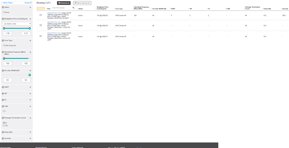

I try to choice the processor with the filter list. Something goes wrong here. In the image dorpped here,
The three processors appear not to have any CAN, while in the first column they offer 1 or 2 of.
If I additionally filter to have at least 1 CAN the result is empty.
My intention is for now to stay large and I will choice the second one,
MKE16F512VLH16
I hope there are 64 KB RAM, 512 KB flash, SPI, CAN, UART.
May be I do something wrong.. If there is an opinion on my usage of the selection filters is welcome..

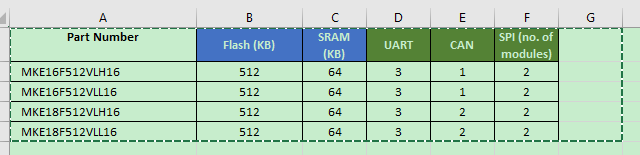

Hi Pietro,
  Your requirement is:64 KB RAM, 512 KB flash, SPI, CAN, UART.
   I already help you choose the according chip from our internal side.
   These are the chip which meet your demand:
Wish it helps you~
If you still have problem about this topic, please kindly let me know!
