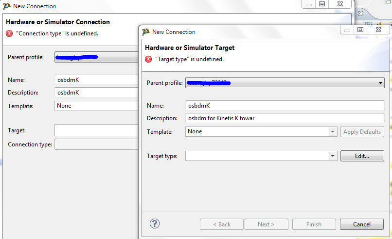

I have a project that was built with a Segger Jlink for hardware connection.  I only have access to OSBDM or a PEMicro universal multilink.  Is there a script to follow in order to modify the project settings to change the build to use what I have access to?
I am stuck at this stage.  I don't know how to import something from lets say a project that is already configured correctly.

LuisCasado
You can create a new connection like in your screen attached, completing the target device and the hardware debugger interface or just change the hw in the segger existing connection. Go to debug configurations > Select the configuration for Segger > press Edit button and in the Connection Type, select P&E instead of Jlink.
That's all.
Luis

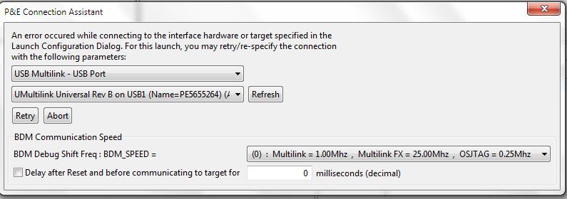

steve_fae
Senior Contributor I
so I changed the settings from jlink to PE multilink but it won't connect
first captures shows setting second shows connection error
what i have in hand is a universal multilink but it seems to have found an FX??

LuisCasado
The connection configuration looks ok. Do you have the two Multilik led's on?
I think you can do two things:
1) Create a new project with CW wizard and try to connect.
2) Enable log in debug connection to see what error is reported
How are you powering the TWR?
Luis

steve_fae
Thanks, using straight usb connection with OSJTAG I got a connection.  Now need to get panel to light up.  Thanks
