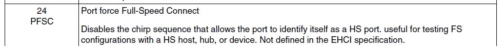

I am using a K65 device and we are using the HS USB port.  I am wondering if there is a register that I can hit that will force the HS USB port to only support FS USB.  Does anyone know if that is possible?

Look at
Mark
