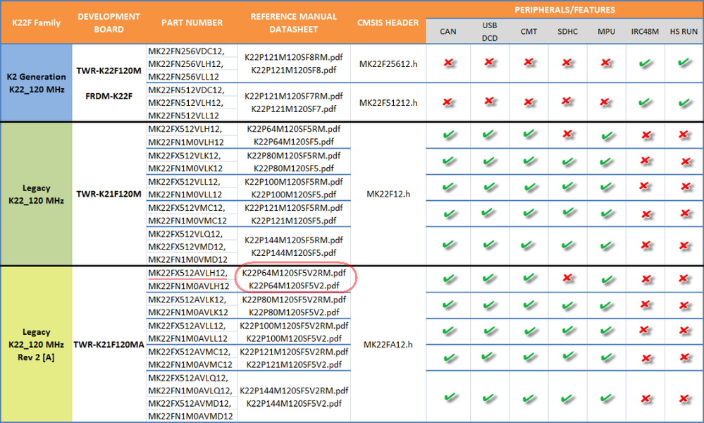

I am trying to find out the information about the CAN or FlexCAN peripheral in MK22FX512AVLH12. The reference manuals under the K22_120 location do not have any info about CAN.

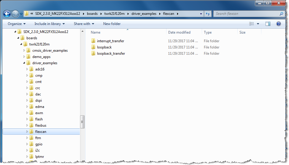

Are there any bare metal code examples for using the CAN peripheral under MX22FX?

K22P64M120SF5V2RM is the reference manual for MK22FX512AVLH12.
You will find the Chapter 46 CAN (FlexCAN) in that document.
I didn't find bare metal code examples for using the CAN peripheral under MX22FX.
Maybe you can refer the flexcan examples in SDK_2.3.0_MK22FX512Axxx12.
