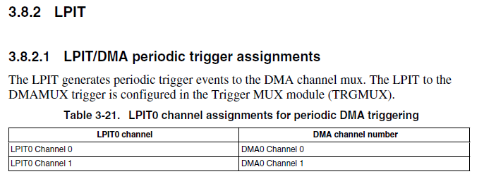

The only reference that I can find to back this up is this extract from the user's guide:
This looks to confirm that the LPIT trigger really passes through the TRGMUX but it is confusing due to the following reasons:
1. It states that LPIT0 channel's 0 and 1 could be used, whereby the TRGMUX allows any of the 4 channels to be routed.
2. It limits to DMA channels 0 and 1 whereby periodic triggering should be possible on channel's 0 to 3.
3. It fixes LPT0 channel 0 with DMA channel 0 and LPT0 channel 1 with DMA channel 1, whereby there is only one (always on) DMA MUX slot, which should be able to connect to any DMA channel.
Therefore I am also wondering whether this extract is really correct or whether the table is a cut and paste from a different Kinetis part that has a fixed slot/channel/PIT source arrangement.

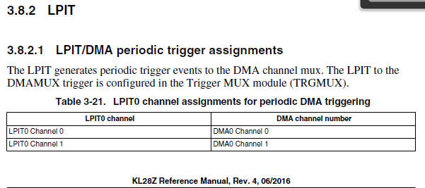

Comparing again to the following:
it suggests that it is misleading:
LPIT0 Channel 0, LPIT Channel 1, LPIT Channel 2 and LPIT0 Channel 3 could be used on DMA0 Channel 0.
None could be used on DMA0 Channel 1 (nor other DMA channels).
What is the official stance on the accuracy of the user's manual in this case and whether the results of these tests reflect the expected behavior?
