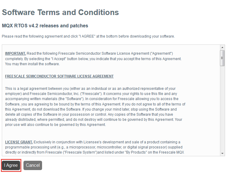

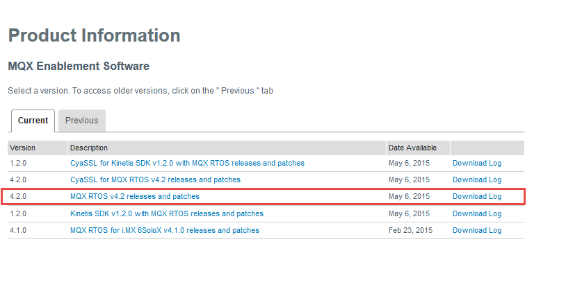

ivadorazinova
Hello joseph,
Unfortunatelly in KSDK 1.1 neither KSDK 1.2. (the newest version) there is no support for TWR_K20D72M.
So you can create new project in KDS 3.0 but not with KSDK.
You can check the information at Release Note for KSDK here http://cache.freescale.com/files/soft_dev_tools/doc/support_info/KSDK120RN.pdf?fpsp=1&WT_TYPE=Suppor...
So I recommend you work with new MQX 4.2, there is support for your board.
You can check it with Release Note for MQX 4.2. http://cache.freescale.com/files/soft_dev_tools/doc/support_info/MQX_Release_Notes.pdf?fpsp=1&WT_TYP...
For installation MQX 4.2:
and that´s it.
For next steps I recommend follow documentation and follow created examples.
