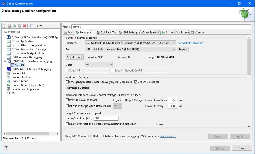

Hello
I already used the pemicro USB multilink with Kinetis K60 and K70 (On CodeWarior and KDS)
Now, I start a new project on a K02 with MCUXpresso.
But when I want start the debug, I get the following error (like if target not connected) Refer to the attached jpeg.
What I should check first? (Blue Led and Orange Led are well light on on the PE micro Multilink universal.
To resume, the IDE is new for me and the microcontroller is new for me. then It is not easy to determine if problem comes from the hardware or something into MCUXpresso..
Please find the hardware schematic.
Thank for your help.

Hello
It is an MK02FN64VLH10.
But I just found the problem, it was a short-circuit between TDO and TCLK.
But just a question, we link the JTAG Reset to the pin of MCU 'JTAG-RST' wichi is by defaut a gpio pin function.
Then Should we instead link the Jtag reset to the RESET pin of the MCU K02?

kerryzhou
Hi Arnaud Girard,
  In fact, you are using the SWD interace in your code.
Your debugger can support the SWD.
Now, what's the debugger result?
Do you have Segger JLINK on your side? If yes, you can use the JLINK commander to connect your board at first, whether you can find the ARM core or not? If you can't find the ARM core, it means your hardware still have problems.
Kerry

kerryzhou
Hi Arnaud Girard,
   Multilink can support the SWD directly.
Other port is the same, you just need to use the SWD_DIO, SWD_CLK, RESET, VCC and GND.
Kinetis chip related pin: PTA3 is SWD_DIO, PTA0 is SWD_CLK. RESET is your MCU RESETB.
About the MCUXPresso IDE, do you modify the JTAG debugger interface? If not, it should in default using the SWD.
Kerry

kerryzhou
Hi Arnaud Girard,
   Thanks for your updated information.
   Do you try the SWD interface instead of JTAG?
  SWD_DIO is better to add external 10K pull up.
   Reset_b pin need to add external 10K pull up and 0.1uf capacitor to ground.
  About the reset,  normally, we connect the MCU reset_b pin to the SWD interface.
  It means, the SWD interface have these signals: SWD_DIO, SWD_CLK, RESET_b, VDD and GND.
  Can you accept the SWD interface?
Kerry
