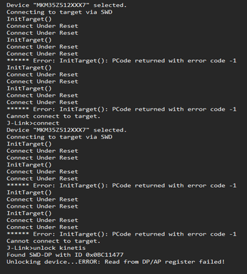

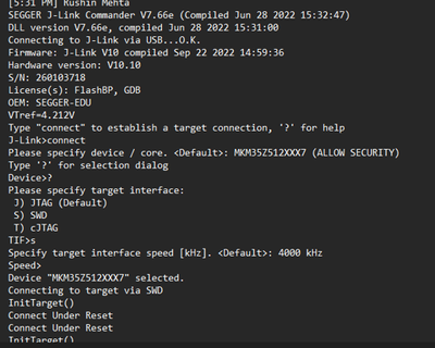

I have program Km35 Board by McuExpresso IDE using jlink connected to k20 JTAG port. After that, I was unable to view the opensda drive or the com port.
1. I've tried with Jlink Commander. JTAG is linked to j24 port on the km35 board, And program Board Using SWD For the first time I am Successful to program code but when I tried Second time I can not able program .
I tried to plug in the USB and remove the J6 jumper to directly power mcu  and when I send connect command  I immediately put jumper back but still could not able to connect.
I connected JTAG to k20 JTAG port and download Bin for opensda I have Successfully load file but could not recover drive and after that when I  try connect Can not able to connect.
I have also change board but in other board also Facing the same issue.
How to restore Drive Back I need to programmed the board with the cmsis dap linkserver.
