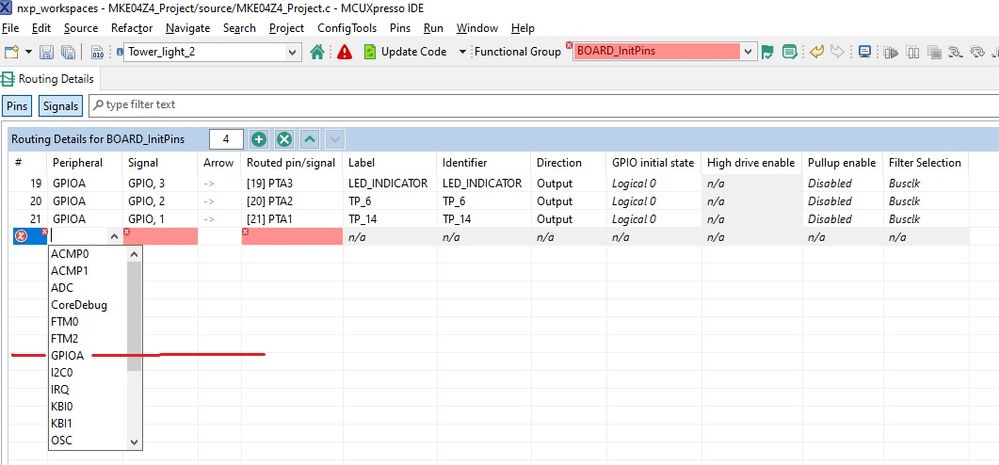

I'm developing for the MKE04Z8VFK4 on custom target hardware using MCUXpresso v11.6.1 on a Windows 10 box.
My latest problem is that I am unable to configure GPIOB and GPIOC pins using the pin configuration tool. When I add a row for a PTBx pin and click on the Peripheral cell, the drop menu only contains GPIOA. I also tried just typing in GPIOB or GPIOC but the tool doesn't allow that.
(See screenshot below)
How can I configure PTBx and PTCx pins with this tool?

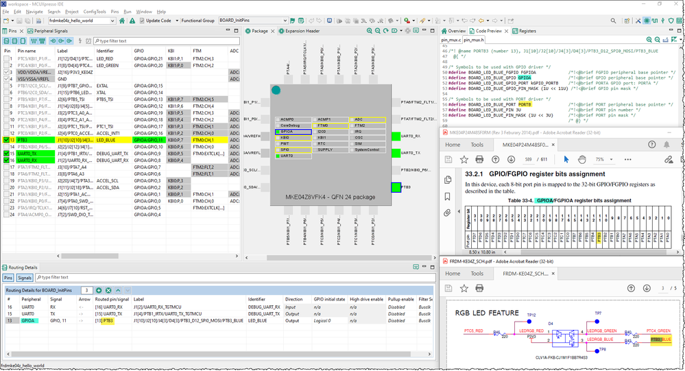

Hi Mike,
Sorry that the names of GPIO registers and port pin registers of KE series may confuse you in MCUXpresso IDE.
Please refer to the example of toggle PTB3 on FRDM-KE04Z:
Robin

Thanks again, Robin for your patient support!
The 'A' at the end of the peripheral name was the confusing factor for me, but now I'm back on track.
