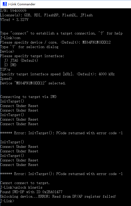

   I would like to program frdm-k64 using j-link tools, but enter problem.
   It can not connect to my board, and say that:

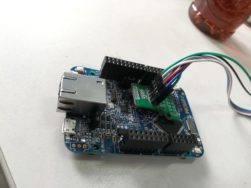

I did use a standalone jlink on the JTAG(J9) connector, and it can not connect to FRDM-K64.

Have you checked the power supply?
2,163 次查看
hxc
Sure, but it doesn't work. And it work fine on the other board. I can not find it out.
