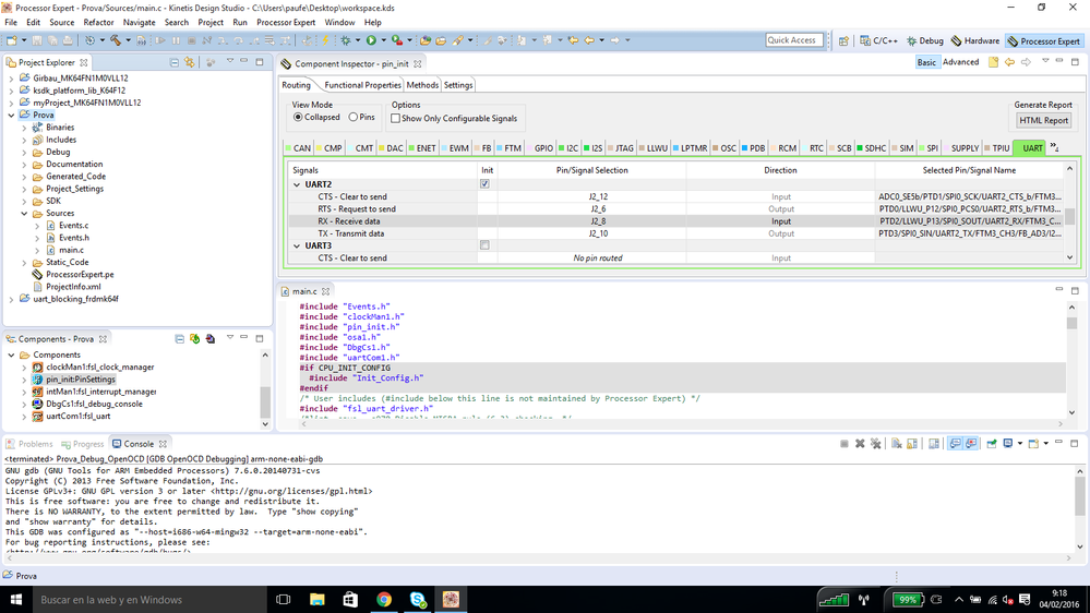

Hello guys,
I've been trying to communicate with a slave device using FRDM-k64F via UART2, i have already configured the pins so they act like tx/rx , also configured the baud rate and have MX485 beetwen the board and the slave.
I'm really new using these kind of boards and software, i've done the tutorial like 2 days ago.
I'm attaching my project so you can have a look at it. Please if you see i'm doing it wrong a little advice or guidance would be much appreciated
If it is not possible to do a No will do it.

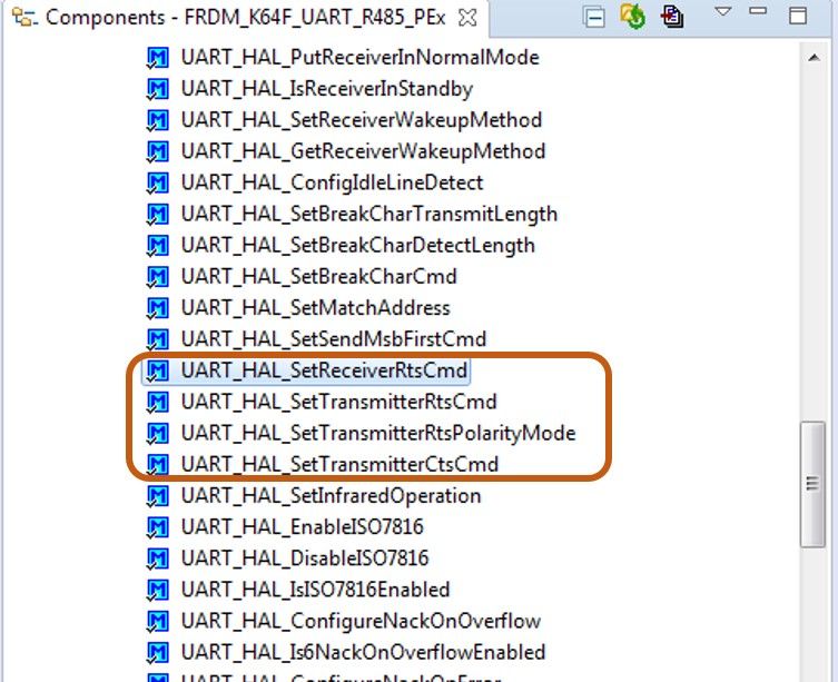

isaacavila
Hello Pau,
As Mark already told you, K64F has its own hardware control over these signals (RTS and CTS), so you only need to configure UARTx_MODEM register as you need.
If you are using PEx, you can use UART_HAL_xxx functions to enable/disable RTS and CTS functionality. In your fsl_uart component, you can find HAL functions and there are some related to RTS and CTS:
These functions allows to configure MODEM register. For example, if you desire to configure RTS with high polarity, you can call:
  UART_HAL_SetTransmitterRtsPolarityMode(UART2_BASE_PTR,true); /* true = high polarity , false = low polarity*/
  UART_HAL_SetTransmitterRtsCmd(UART2_BASE_PTR, true);
Also, you can enable Clear-to-Send functionality on transmitter and/or RTS on receiver.
You can also check fsl_uart_hal.h file for more reference on this HAL functions.
I hope this can help you!
