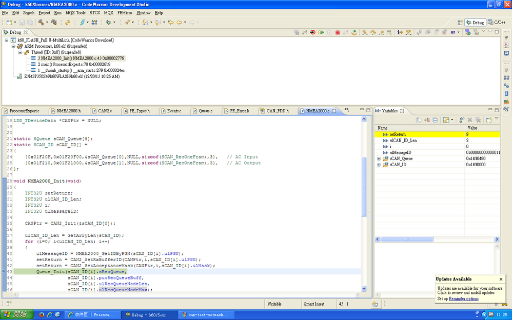

when i call it,it will return 9 ERR_NOTAVAIL
how to use?

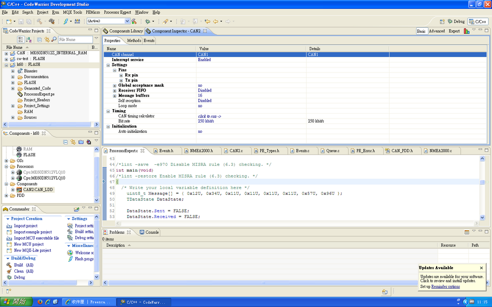

Hi 志權 ,
     Could you tell us which chip or board you are used?
     And where the CAN2_SetAcceptance Mask from?
     For the convenience of solving the question, it is best for you to paste you 9 ERR_NOTALAIL.

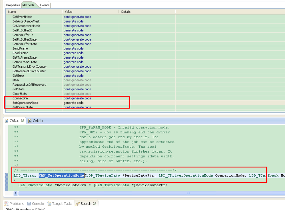

so,how to enter freeze mode and how to exit freeze mode?
3,570 Views
Kan_Li
You may use "CAN_SetOperationMode" to enter or exit the Freeze mode. Please kindly refer to the following for details.
Hope that helps,
B.R
Kan
