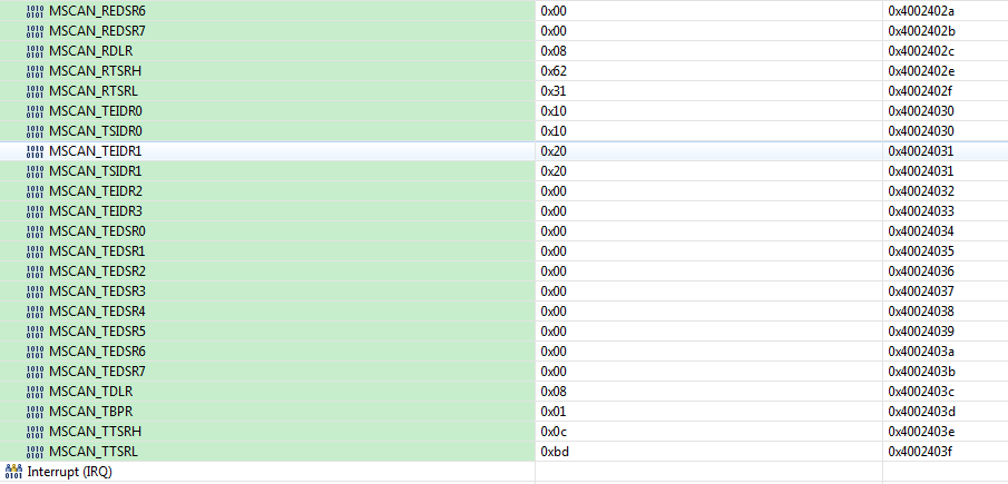

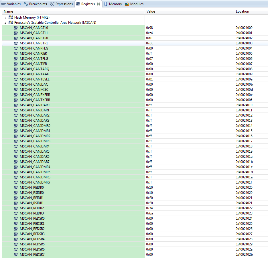

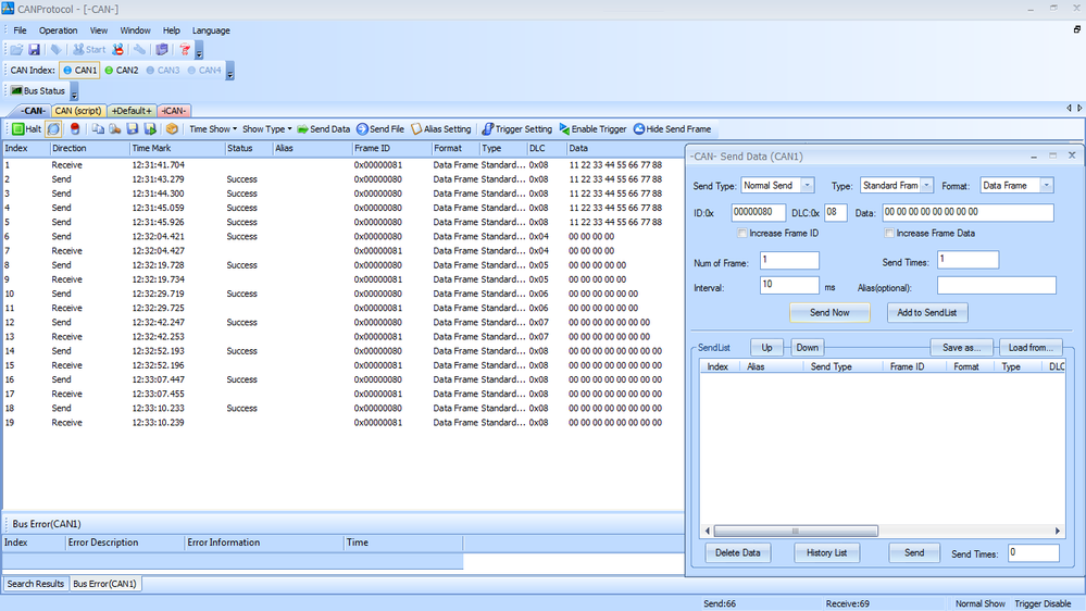

Hui_Ma
I do a test with TRK-KEA128 board with MSCAN driver and could get CAN data frame: 00 00 00 00 00 00 00 00 with <Demo_Receive_DataFrame>.
In <main.c> file using below code:
    TEST_CASE_FUNC(Demo_Receive_DataFrame);
Please check below test result:
The MSCAN module registers value below:
Wish it helps.
Ma Hui
