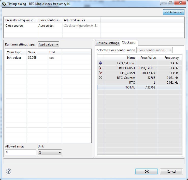

Hi I have a FRDM-KL26Z that I'm using to prototype a new design using KDS2.0.0
I’m trying to use the RTCx:RTC_LDD & the internal 32KHz clock. In the final design I've got an external 32Khz Osc 10ppm, but for prototyping I'm trying to use the internal 32KHz
In the RTC Properties the “Input Clock frequency” can only be set to 32.768sec – even though the “Clock Path” suggest that it should be able to access the RTC_Counter.
However the RTC_Counter souces seems to be wrong at “0.031Hz” – possibly should be -.”0.031Khz”
On the CPU:MKL26Z128VMC4 component I have the RTC clock input disabled.
System Osc – Enabled – 8Mhz &
ERCLK32K Auto Select – LPO 1KHz

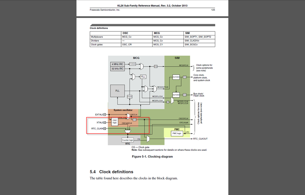

RTC can not operate with internal slow ref clock, because RM says"RTC prescaler is clocked by ERCLK32K.", and if you refer to "Chapter 5 Clock Distribution", you may find there are only three options for ERCLK32K, but nothing to do with the internal 32KHz clock , please refer to the following for details:
and by default it uses LPO as the internal clock, and as RTC_TPR increments every 32.768 kHz clock cycle, so you may think it has a prescaler of 1/32768, so going down the clock path , the input 1KHz has the output of around 0.031Hz, just as below:
